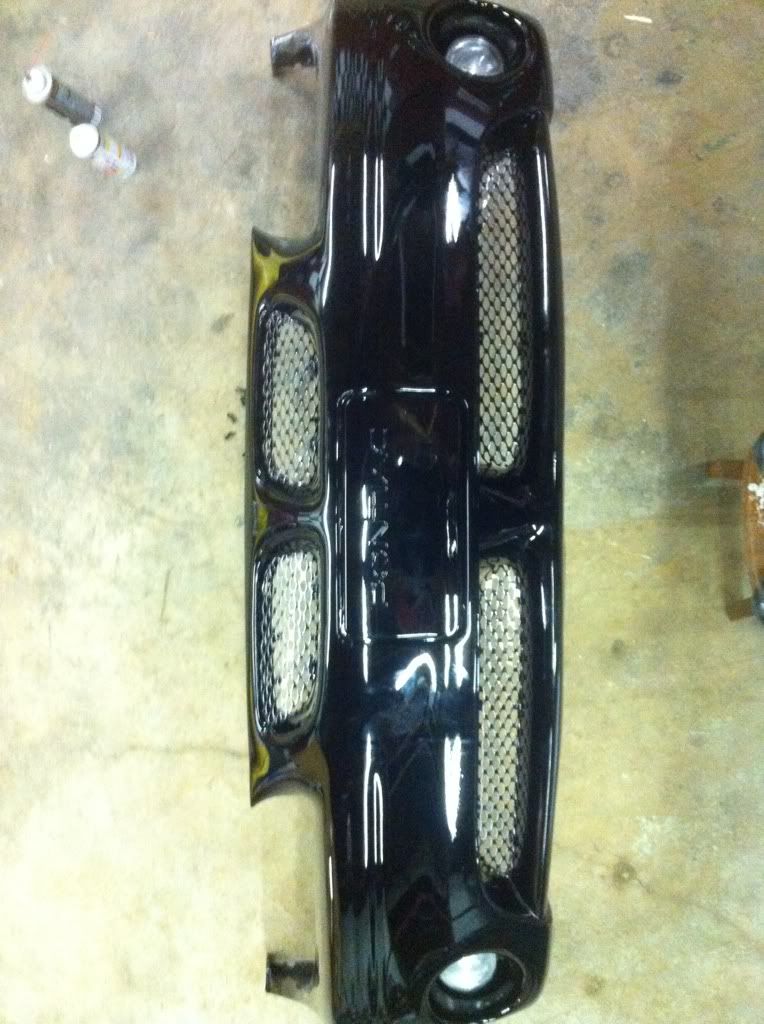

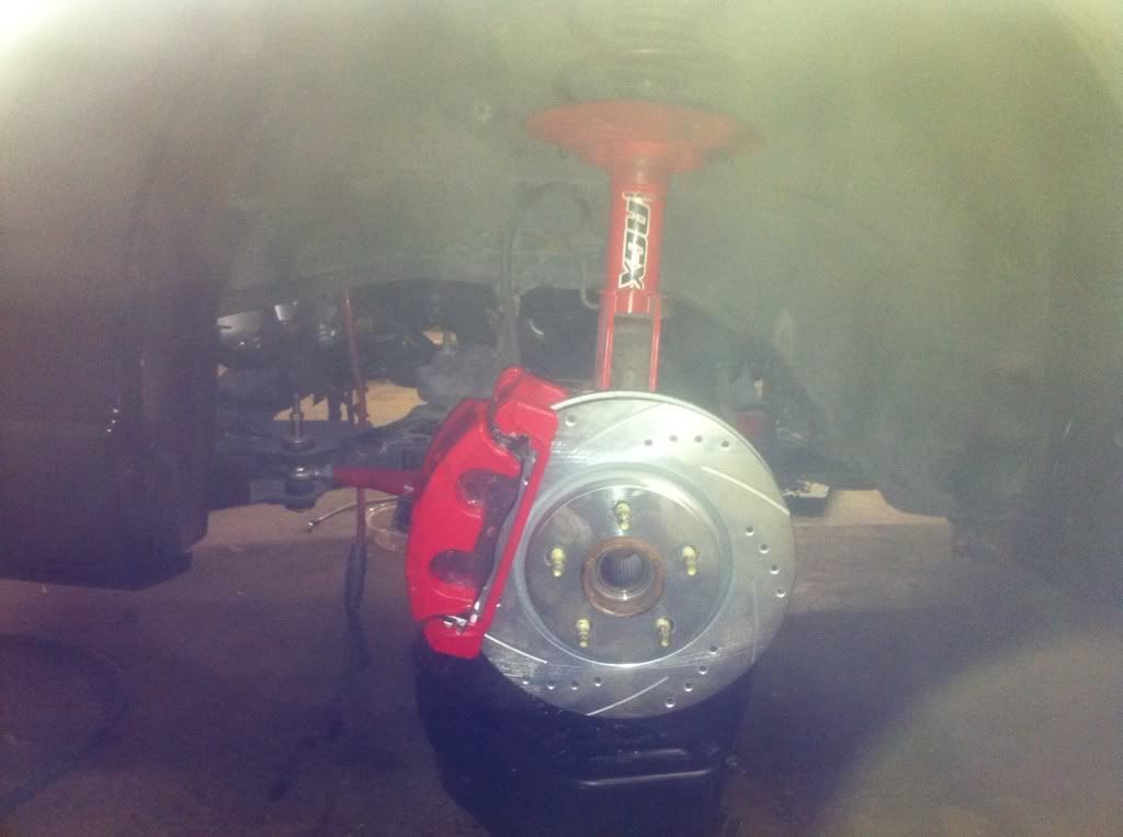

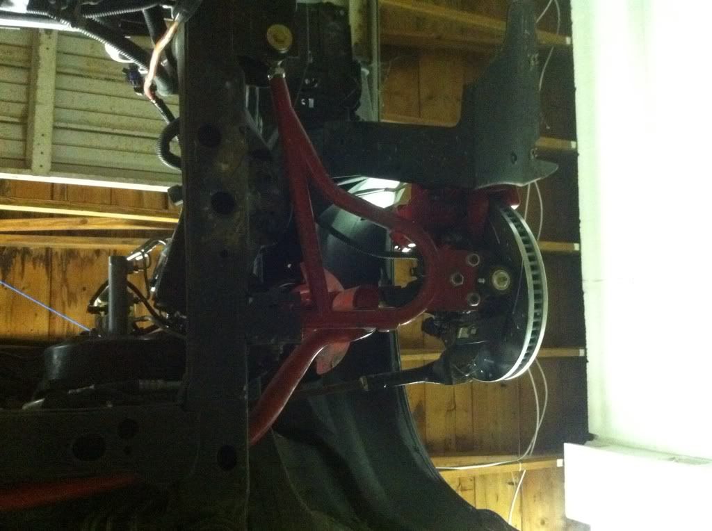

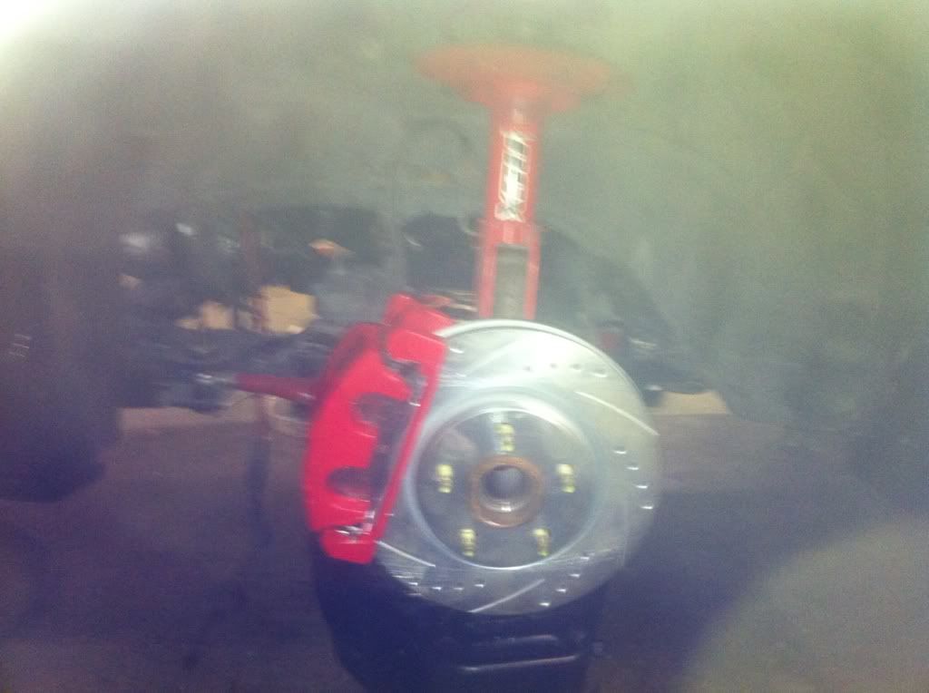

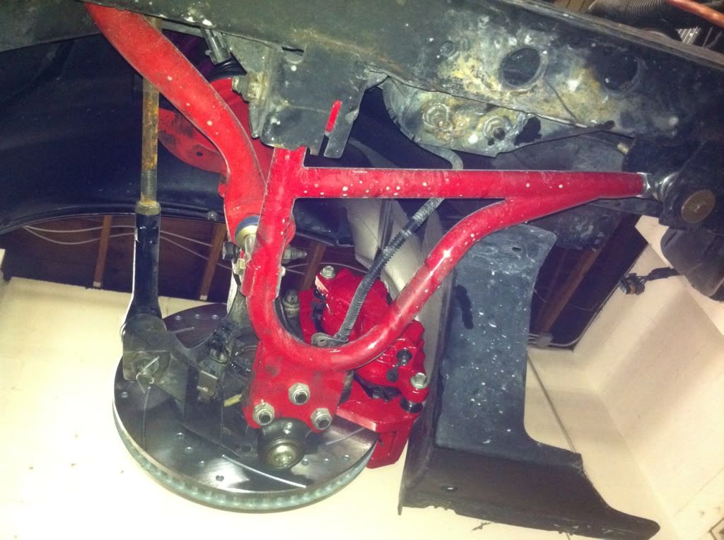

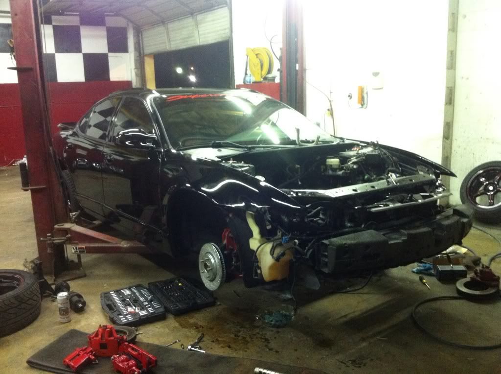

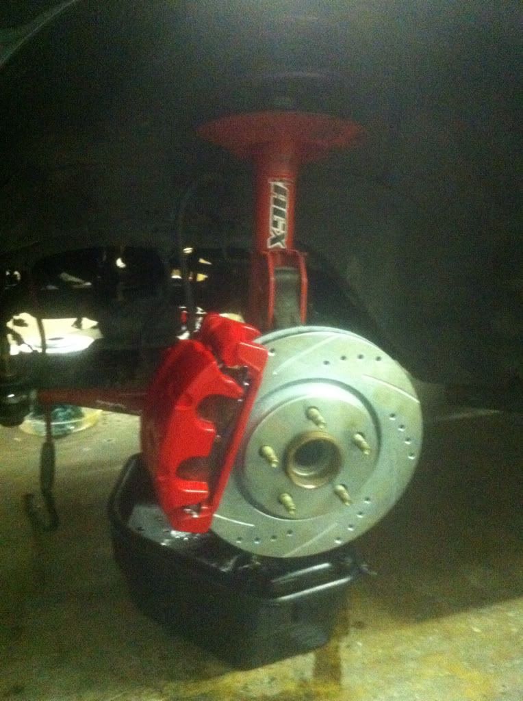

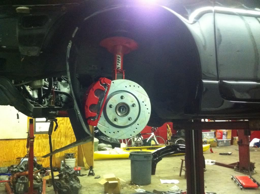

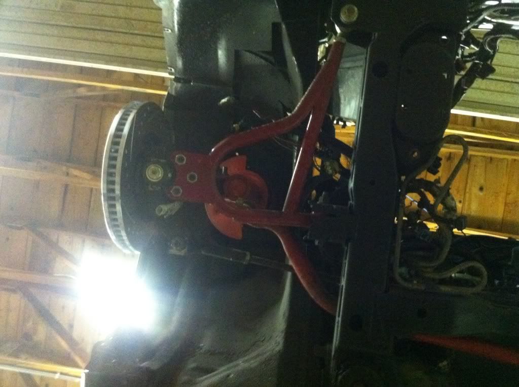

    Oh Hey spartan got around to putting his new brakes on yay!
    Also put my Street Scene Black Chrome grillz onto the bumper tonight (ill do my foglights later this week)

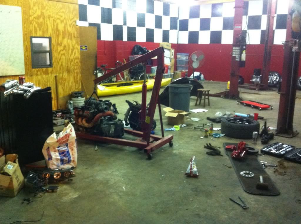

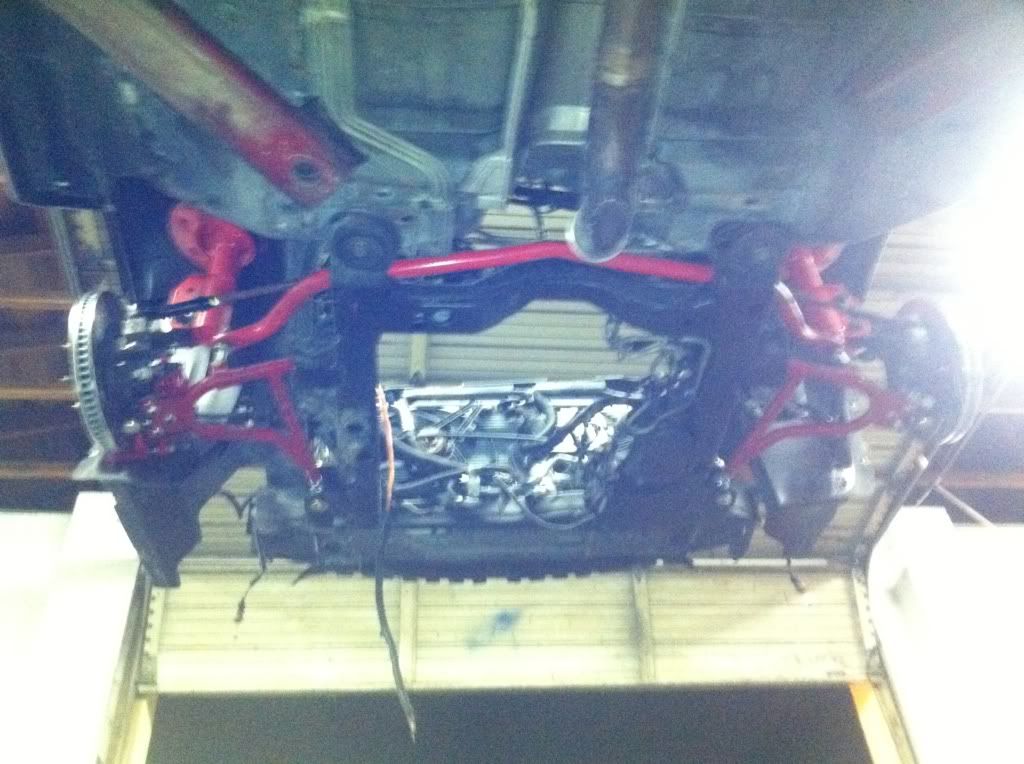

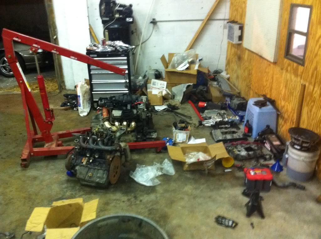

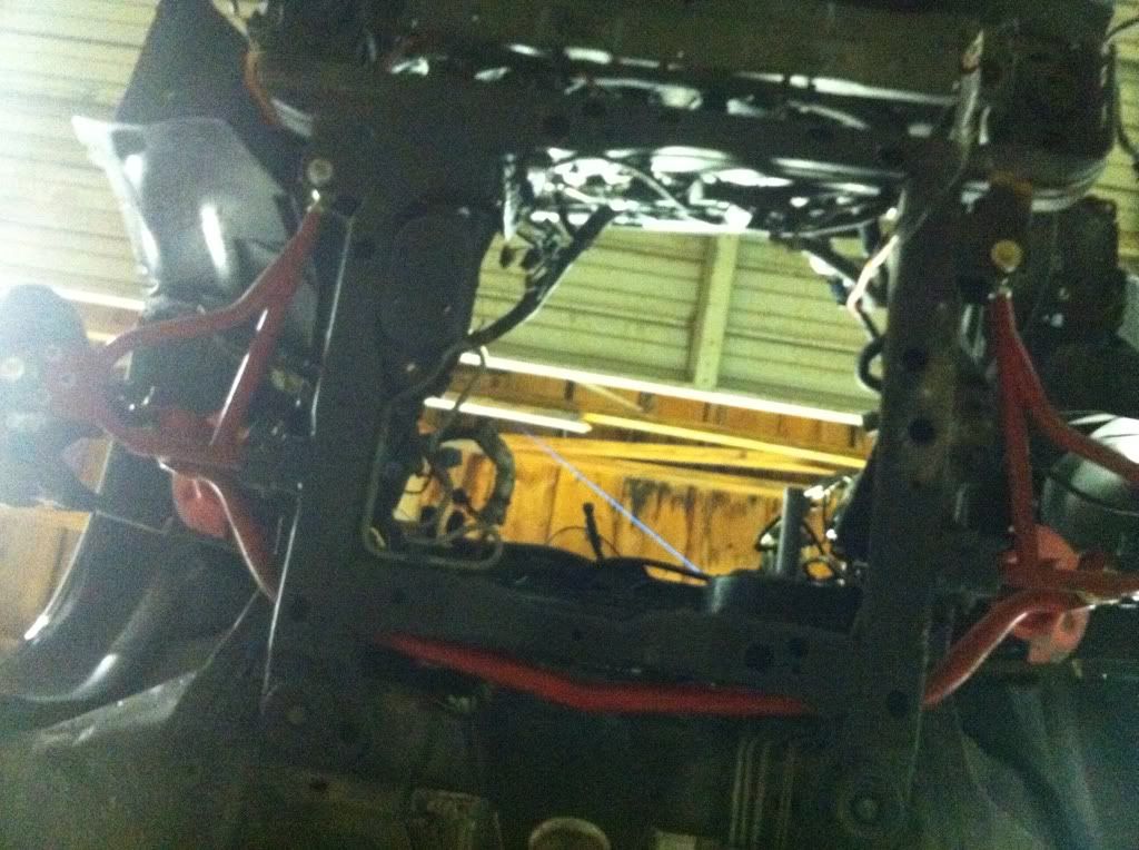

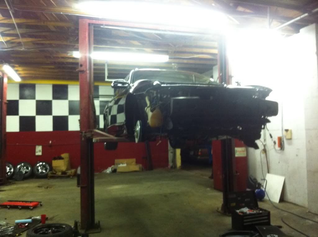

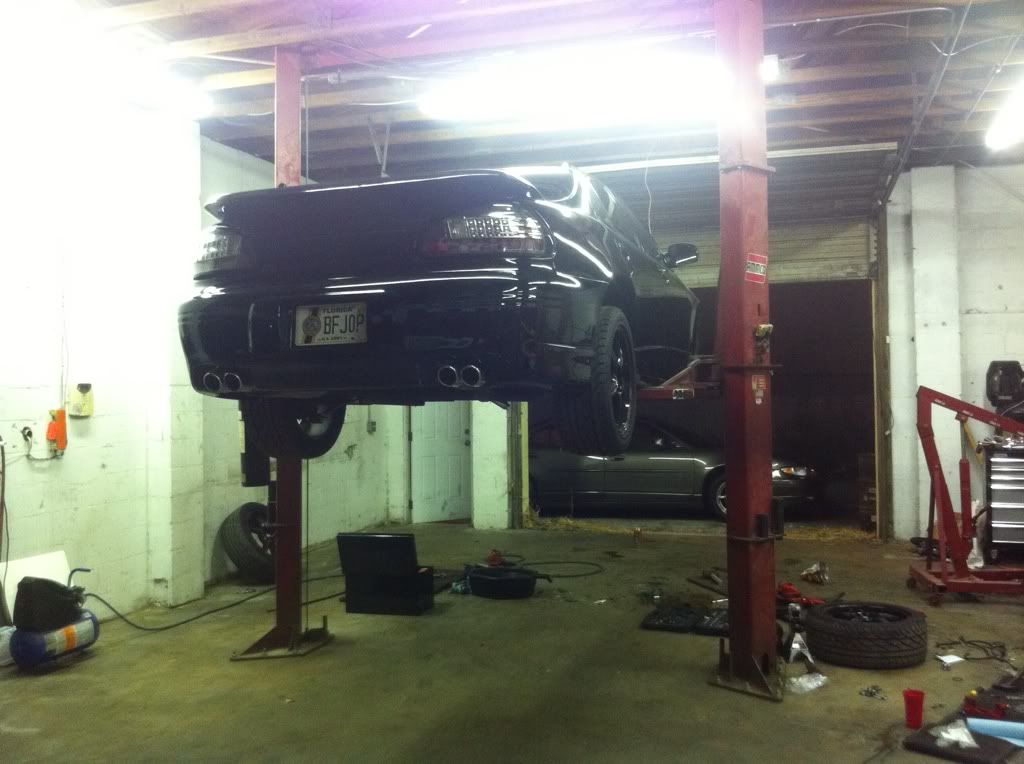

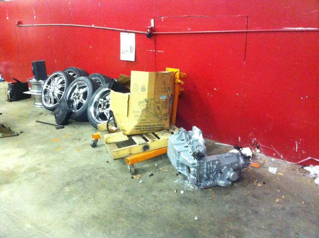

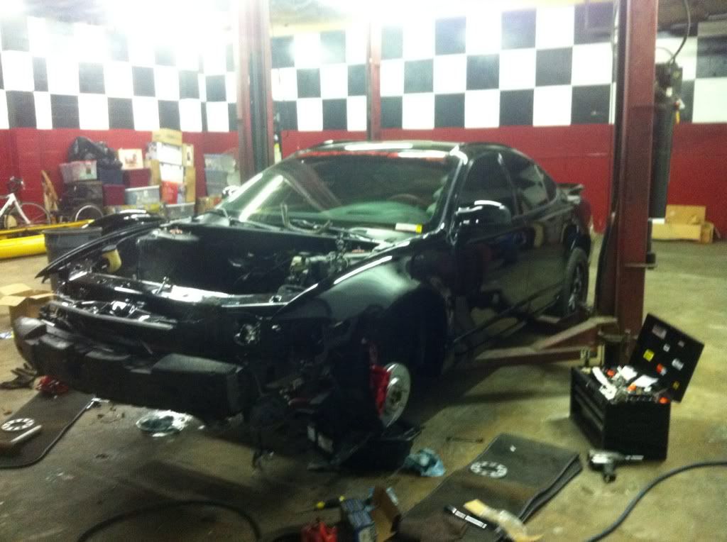

    and here are some random shop photos i took for your pleasure.
    also gotta alittle crazy with a lift and the little cart thingy to roll under cars with
  8. #8 Re: Spartan GL's (01/30/12) PG 27 I have the GTP back from the Painter!!

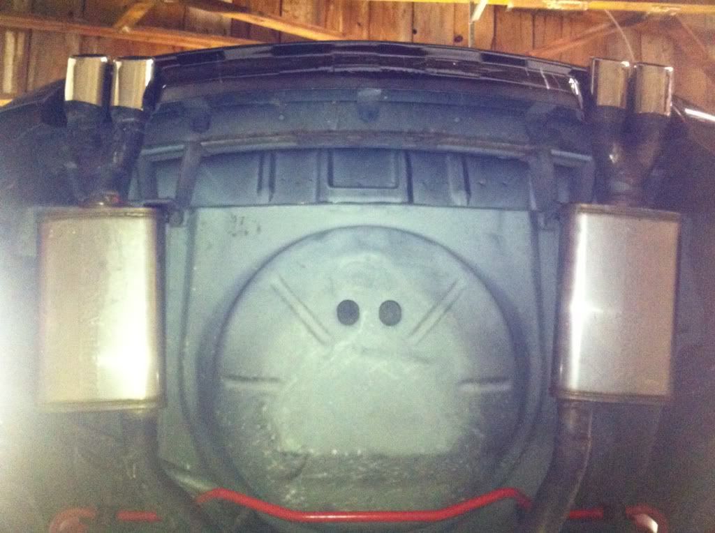

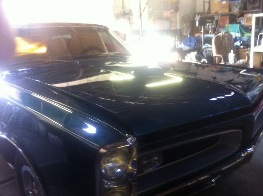

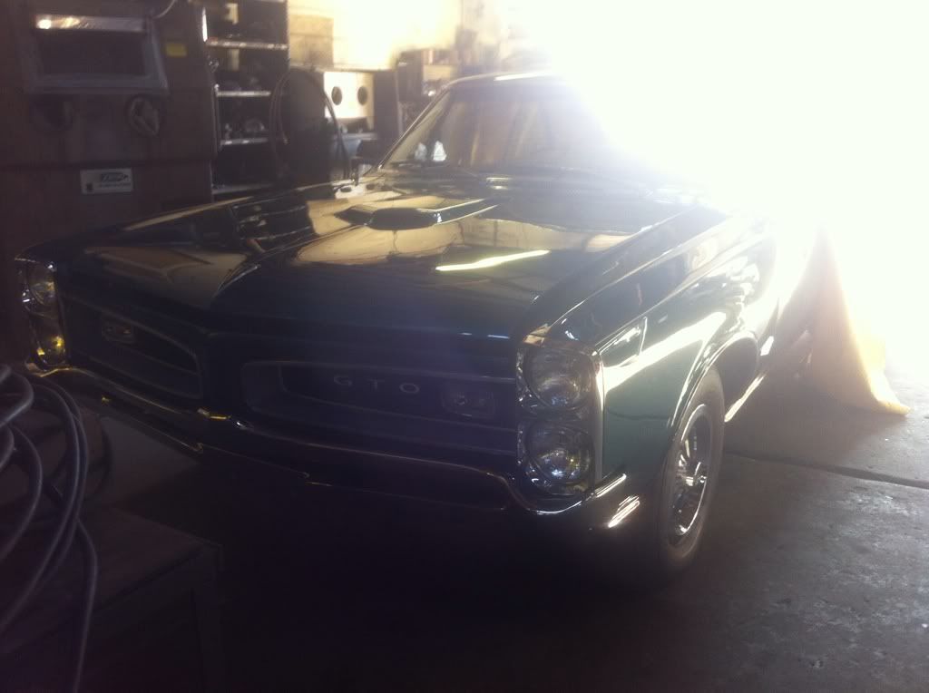

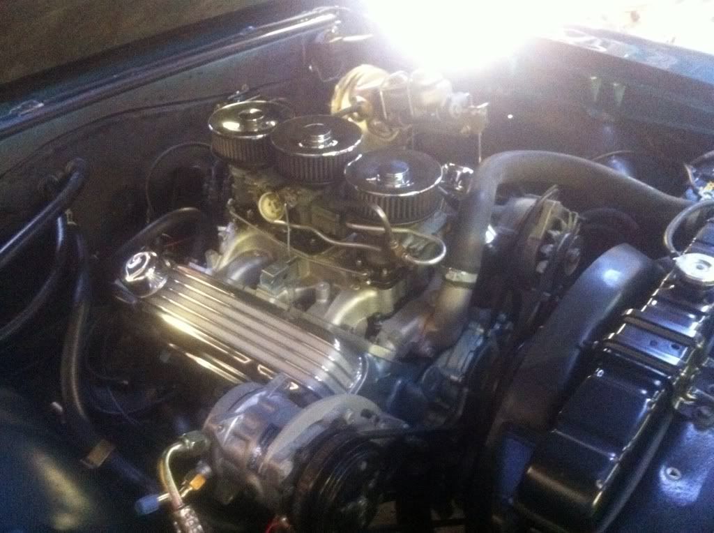

    I gave my GTP a Redbull now that ***** can fly!
    Also Derricks GT (Top swaped)
    I've seen that blower somewhere before... just can't pinpoint it..

  10. #10 Re: Spartan GL's (02/02/2012) PG 28 Brake Setup photos! and New Grillz

    lol i like the random canoe just sittin in the shop.... car looks good.. cant wait to see it completed

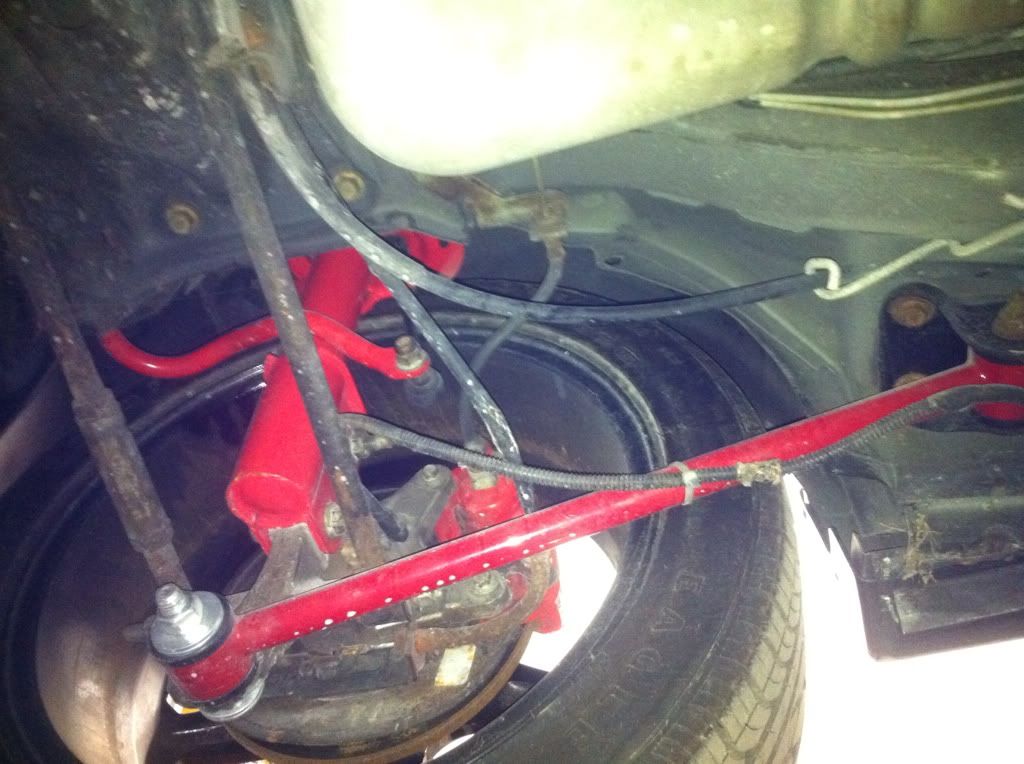

    GM Part # 10335973 for the driver side i think... can someone confirm this to be the right part? also need the passenger side and more then likely the rears too
  17. #17 Re: Spartan GL's (02/02/2012) PG 28 Brake Setup photos! and New Grillz
    Oct 2011
    34
    Quote Originally Posted by Spartan GL View Post
    P/N 10335973 is the pipe for the RIGHT side. The LEFT side is P/N 10425230. As far as the Rear is concerned, it looks like GM's solution is bulk line. The only thing they show is 3/16" x 20' roll. I can come up with P/N's for the rear hoses, but no pre-bent metal pipes.

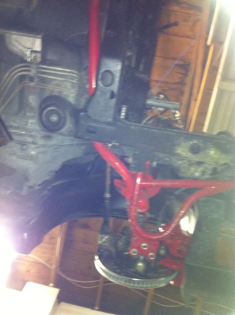

    Also I need alittle bit of advice, I am replacing the rubber brake hoses with stainless steel lines (already have them including the 5th brake line)
    BUT the Brake HARDLINES that run all the way to the master cylinder are pretty much not ever coming off the rubber lines (bolt is stripped beyond repair) so i remoeved the lines all the way to the MC and took them off the car, i am going to need a replacement set OEM or aftermarket is fine can anyone recommend a good replacement option?
