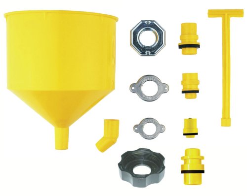

    I agree and own one myself. Best funnel you'll ever buy and ... you'll never touch another bleeder screw.
