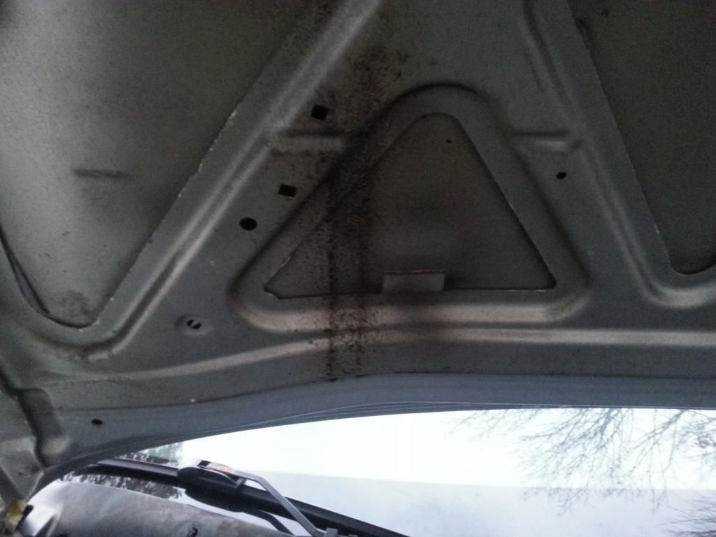

    The only thing I have noticed is that one of the pulley's are dry and has kicked out
    all of its grease onto the underside of my hood.(I have this pictured below) Is this bad to keep like this? How hard is

    The oil on the hood is there from the belt slinging it up. Not necessarily from the pulleys. Besides the bearings are not filled with a grease that could come out like that. That's from something leaking near the belt. CV boot, oil pressure switch, etc.

    your racing stripe is from the water pump leak, or a axle boot has torn, slung grease all over to the likes of the belt and the belt slung the grease on the hood.

    My car did that for a while. Turned out the coolant elbows leaked fluid and the belt was tossing it everywhere.

    Is there a way to tell what it is exactly that has broken/torn and leaking the grease onto the belt by the type of grease?
    Its thick and not real sticky.

    if you got ramps, or a jack and stands, you just need to get under the car and look for the main source of grease, or oil, or coolant.
    if its a axle boot under the car will be a real mess, easy to see wtf went wrong there.
