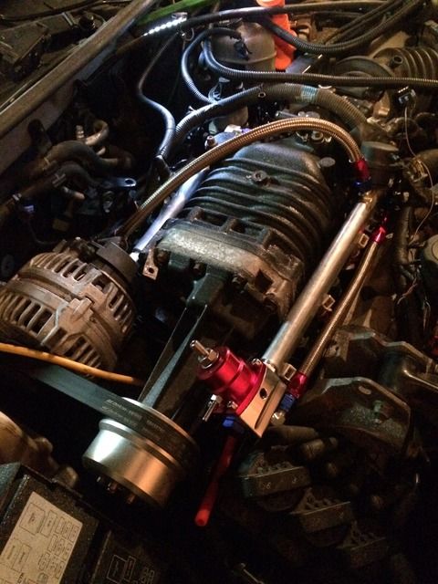

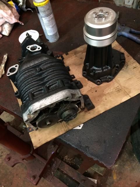

    New guy here, I'm the owner of an 05 impala Ls. I've joined here for obvious reasons. I have found this forum so helpful in knowledge on this platform . I have spent the last few weeks browsing old pages and getting some hints and tips for future mods.
    From newfoundland, Canada. 21 year old mechanic with a love for cars and especially impalas. I've owned one 97 gtp sedan a few years ago and it was the cats assss! Even though these are front wheel drive.
    I've just "finished" a m90ss swap. And have a few more plans in mind for the winter. But just after having a newborn, and buying a house leaves me with little time to play! But I like to stay up late and gain some knowledge and get the old tinker moving!

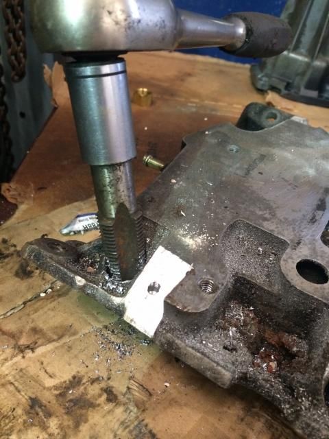

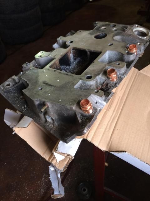

    I stole the idea from zzp, and modded my own intake, not the best. But the whole goal was to do it on my own and not have to source so many parts from vendors

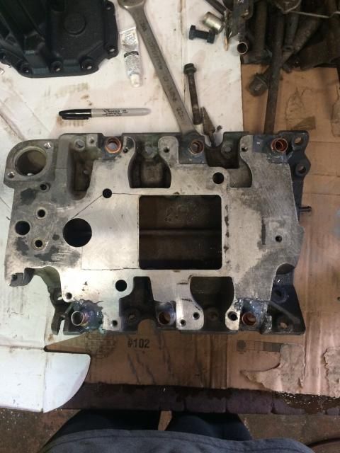

    Did you jb weld the injector bungs on there?...

    Nope. Drilled and tapped for these funny plugs I bought at a hardware store. And cut the injector bungs off an injector rail and pressed them In the plugs . I can get more pics. There just the few I had on my phone

    Ah i gotcha, that is JB weld around them I see isn't it though?
    04 GTP -HAI, 1.9 rockers.
  7. #7 Re: New member, 05ls
    Oct 2014
    St.Johns NL
    12
    Sadly it is. I needed something to kinda mild around them to cover up the look. And to seal any little pinholes that could be there. I figured it would be fine. But over time I'm going to clean everything up and tidy all the imperfections. I'll try to get some more pictures up soon. I have it running, I just didn't drive it on the stock PCM. I just received my PCM back from zzp today. I'll put it in tomorrow and take it for a run.

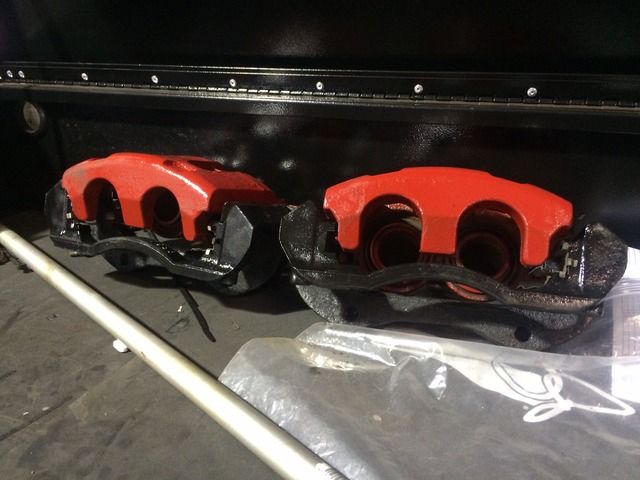

    Update after months lol. I bought an 05 impala ss to scrap so i took all the ss specific items for myself anf kept the motor to build over the summer. 2.5" dp i made, fuel rails i made, ss grill, pannels, and gauge! 06+ front brakes! More to come.. Also shes lowered .
