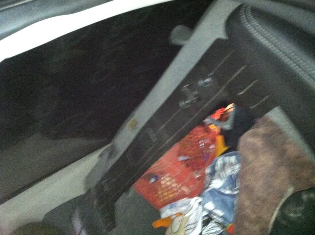

    Remove this freaking plastic peace? My amp is vibrating and it's pissing me off and there's no bolts holding it in place or how the hell do I tighten it down? Can't even have bass at +2 without it vibrating!!!! Fml Am I just stupid or what? Unbolted it and it still wouldn't budge from the black edges of the seat

    I'm usually pretty good with pictures. Maybe I was concentrating too much on why the heck you'd put this in intro instead of the correct area. I can't quite figure out on that GXP of yours what the hell you took a pic of. Although part of me wants to tell you to clean your car.

    It could be another noob question for someone else my thought lol dame grave yard shift thinking, it's the brace that the seats hook to, to keep them in place... And ya we just went to the lake so blankets in there and then the little welder lol I do alot of random stuff to the car at night time when I work.. Also have a jack and tons of cleaning stuff lol

    Without that bar the seats wont stay up.

    Remove those 4 bolts in the picture should be 10mm. Then you should have remove to fix the amp. If you need more room you can completely remove the seat by popping the lower seat cushion out and then theres 2 bolts and 3 nuts holding the rest of the seat bracket on. Once you remove the lower cushion look at the bracket itself and you'll see the bolts/nuts that Im talking about.
