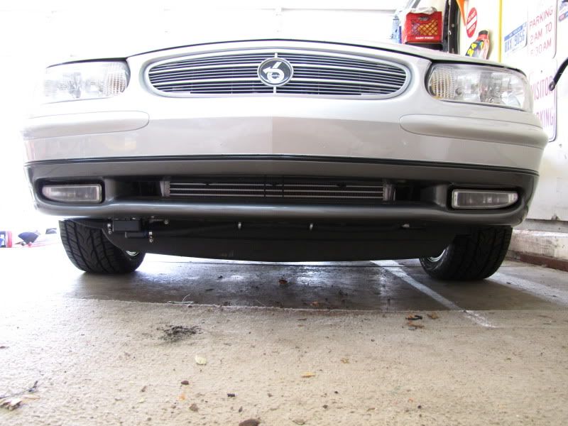

    Bill, what do you think about my FMHE install?

    How much of it is covered by the crash support?
  8. #68 Re: Lurking Regal owner
    GT Level Member glendayle's Avatar
    Salt Lake City
    328
    Don't have the bumper cover on, but based on photos I've seen from other people mounting in the same place, it's about 50%.
    Here is a photo of someone else's car.
    1999 Regal GS Mods-180 tstat; CAI FWI; ubend delete/3"DPCB PLOG; HID fog conversion, 3.5, tint(42%/20%), TK Trans 3.29 gears
  9. #69 Re: Lurking Regal owner
    26,833
    Did you get the bottom tabs on the lower part of the rad support? That's the typical way I see/do them in this area. We have too much weather etc to do much else. You should get decent airflow with that .
    Yeah, I used a couple of body clips like you suggested. I had to cut part of the lower support since it wasn't a straight line across. You can see that my FMHE isn't totally level, but I don't forsee any problems. I posted that pic from Paul's car above. I know that he mounted his FMHE there as well, so I imagine mine should look pretty similar.

    I know about that coverage, im curious about the crash support.
    Well, I guess I don't know exactly what you are asking since the bumper support is directly behind the bumper cover. If you look at my pics, you can see the bumper support mounting spots. Use your imagination and put a line across it. It looks to be about 50%. Also, there is about an inch of clearance at the corners and 4-5" in the center.

  13. #73 Re: Lurking Regal owner
    26,833
    And honestly removing the support, isn't going to open up the bumper cover for you. It's not like the Bonne I had where I pulled the fogs because those holes were dead center and through the bumper cover.
  14. #74 Re: Lurking Regal owner
    Salt Lake City
    328
    Yeah, exactly why I'm not seeing a reason to cut into it. I actually did have one idea though. I was surprised at how open/hollow that thing was. If I can find some good HVAC stuff from the JY, I may put sort of an "air collector" down low somewhere and loop some lines in through some HVAC tubes that would dump out right at the center of the upper part of the FMHE.(Also on the JY engineering research at this point). I just don't know where I can mount the inlets to get good airflow and not look gay.

  15. #75 Re: Lurking Regal owner
    26,833
    Grab air from around the fogs.
    Salt Lake City
    328
    I was thinking about trying to mount some catchers behind the fogs, but wasn't sure if the fogs heated up the air or not. I'm running HIDs in mine.

  17. #77 Re: Lurking Regal owner
    26,833
    Leave them off...they are fogs. hell you could even pull them. Put melt some black funnels into ovals and hook them straight to where the fogs should be. Attach hose and be done.

    In a GP there are quite a few pieces that direct the air from the bottom inlet to the entire area of the condenser and let it go nowhere else but through the condenser.
    Salt Lake City
    328
    I'll have to think about that bill. I actually like the Regal fogs/housings, so I don't see that happening.

    39,997
    some kind of a deflector off the two openings next to the fogs could work, just to kick the air up a bit.
