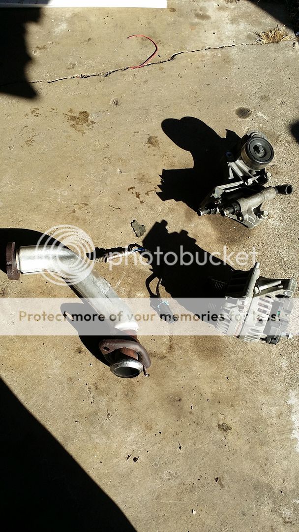

why take the alt and bracket off? unless the elbows were leaking already.

I got new stainless
so I figured might as well do it all at once
Anything else I should swap while I have it taken apart
