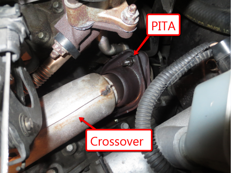

So far I got the plugs out, and front header out and im working on the crossover, I have the crossover heat shield off and im working the second set of 13mm nuts to free up the cross over. Up to this point everything has been a breeze.... the firewall side 13mm crossover bolt will not budge, ive sprayed and sat for several hours. Any tips? I think my issue is I have to use a swivel adapter and cant get enough torque. The crossover spins freely but at any point no go.
http://i135.photobucket.com/albums/q...ps4f5fa018.png
Heat, get that thing glowing with a torch or something and it'll come right off.
Ok that was my next move its just a small space to squeeze a torch in there. Its ok to torch it with penetrating oil all over it right? Or is that flammable? Hope it goes well from here. One last question since it wasnt mentioned in Bills write up, I can reuse my header gaskets right?

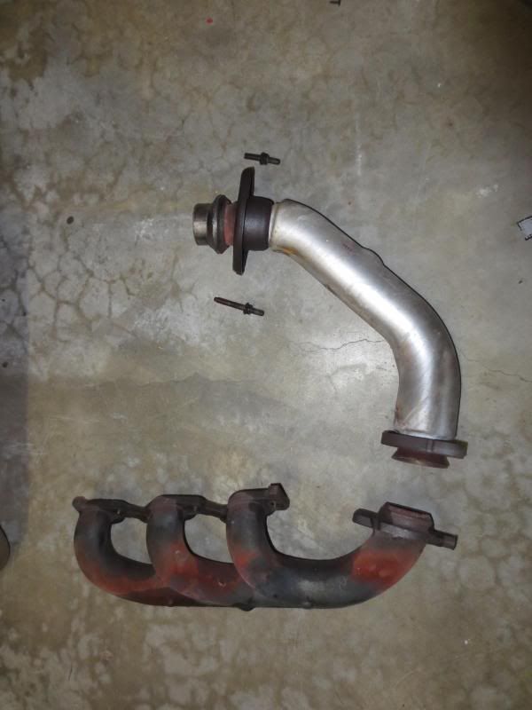

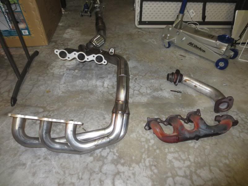

Whelp no need to torch it went after her again and snapped it off, good thing my new ZZPs wont be needing that specific bolt that a win for tonight! Here ya go fellas!
Top bolt snapped off in the collector area

Droooooool

I've always said..if the bolt breaks, it takes less time because of less turning.
FWIW I loosen all crossover bolts a turn or two before doing the rest of any bolt. That way the pressures on all of them are pretty equal. That is about the only trick that may work.
