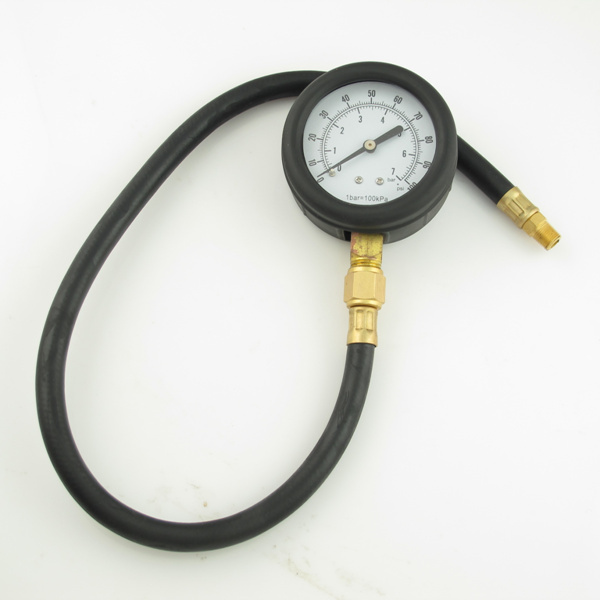

if you have a pressure gauge pop it in the filter housing. even a tester gauge works for this.

test gauge is easy, its at the parts store for free rental it screws right into the oil pressure sensor hole in the filter housing.
http://i00.i.aliimg.com/wsphoto/v0/6...psi-QP0097.jpg
