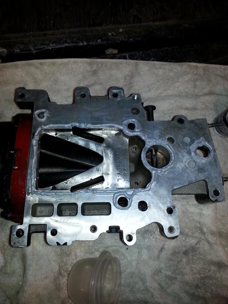

    I know that everyone is going to say you have a vacuum leak but i have tried for quite some time to find one. All my lines are connected. No cracks. I sprayed brake cleaner with it running and i didnt hear the engine speed up or anything. I made sure when i put the supercharger onto the intercooler i used a felpro upper plenum gasket as my diagram and put rtv exactly where you are supposed to and torqued it within 20 mins.

    Soooo, i found my vacuum leak. The good news is that i have no leaks coming from where i rtv'd the supercharger and i have no leaks from vacuum lines Where do i have a vacuum leak? Its from heater core tube where i was supposed to cake on the rtv to put the new intercooler back together. I guess i didnt use enough. Well, that should be an easy fix.
