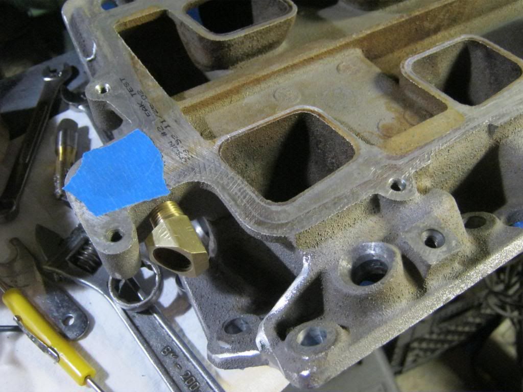

    http://www.grandprixforums.net/threa...7-99-gtp/page7 anthony did this pcv mod to his lim.
    ..... How did that guy only dyno 302 whp with cam e85 fsic and all other mods. .
