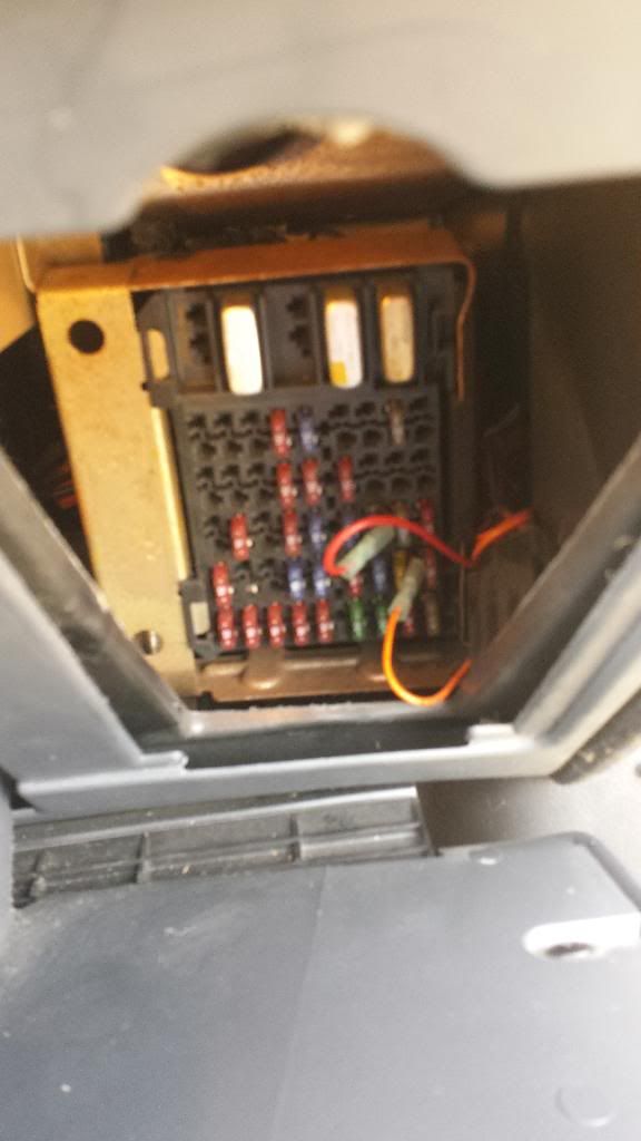

    http://i1121.photobucket.com/albums/...pscopxwylj.jpg there is a picture inside my fuse box in my glove department, there are 2 wires going into 2 different external fuse boxes, how come, I didn't know where to stick the thread and also it doesn't have a alarm on it just the unlock, lock and trunk function

    If it has an aftermarket stereo, that looks like where someone has added power connections for it, rather than use the original power wires.

    Has original radio and the little boxes look stock the have them little white stickers on them like the door panels and everything else has and I can't remember but think they were 15 amp

    Hmm. Not sure what little boxes you're talking about ... you can always just follow the wires with a flashlight, see where they go.

    I'll take a picture of them shortly is just a box a fuse plugs in to

    Oh- fuse holders. Maybe they are leftovers from a previous stereo install and go to nothing. Or maybe they go to another added-on accessory. Trace the wires, see what they connect to. Or pull them and see what quits working. It could be anything but its improperly wired, whatever it is! Possibly could be a temporary fix for a damaged fuse box.

    Goes to sunroof but there's no fuse in the hvac ctrl but it all works
