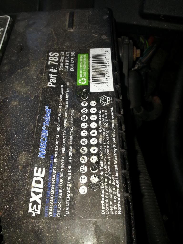

    the months and 1-10 are printed on the label of the battery with "dec" and "2" punched out, does that mean december 2002? if so I'm not surprised I need a new battery lol
  8. #8 Re: time for new battery?
    post a pic if you can. it does sound like its old.
    most are 36, to 48 month battery's, so 3 to 4 years they should last. longer in warmer climates.

    GT Level Member yzboy85's Avatar

  10. #10 Re: time for new battery?

    not sure if its supposed to be 2002 or 2012...if 2012 its within warranty so shouldn't be bad

    i bet its 2012, if it was from 02 no way it would work at all. being your in maine.

    its not even a year and a half old then though =/
  13. #13 Re: time for new battery?
    that would be the sale date, it may have been on a shelf for a year before you got it.
    warranty is good tho, they pro rate the cost of a new battery, the newer it is the less they charge for the new one.
