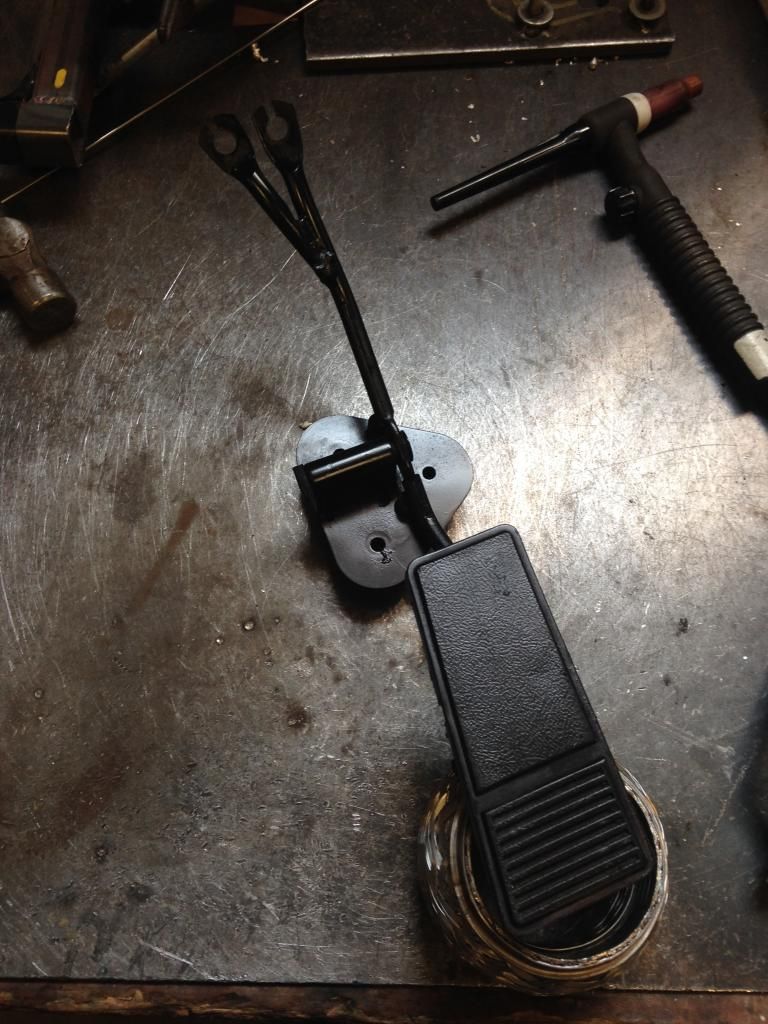

so did you figure out a hand or left foot throttle yet?
Re: Twin engine GTP project progress thread
Turbocharged400sbc
Just added another throttle cable to the same pedal.
I can throttle the rear engine independantly for spooling up the turbo. I can't throttle the front engine independantly.
So I can shut the rear engine off and leave in Neutral while I do my front burnout, then I can do a rear burnout with the front engine still running.
