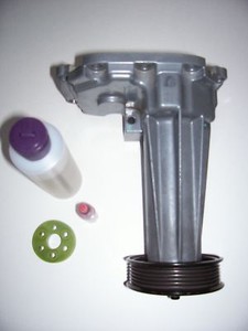

For the add ons, there is ZZP Supercharger oil (6oz) or GM Supercharger Oil (8oz). Which should I choose?
It takes roughly 7-8 to fill it, and because you are taking th snout off, you will want 8.
If I remember right, the zzp oil had more in it than the GM. They made it so you only need one bottle to fill your snout. Or atleast that's how it was when I did mine in October.
So it sounds like the ZZP is the perfect amount and the GM is too much. Any difference quality wise?
I also read that we can use Mobil1 5W30 synthetic oil??
You "can" but it wont work as well or will break down. There's a reason they have a specific formula for it.

Alright so I'm gonna try my best here to contribute to all this good advice. Granted I'm on a Gen V (2004+ Supercharger in case you don't know) and I have a belt wrap on, I've got some pictures to tag along lol It's really super easy to do, shouldn't take you to long. After you get the belt off, you've gotta take the snout bolts off. (10mm like stated) I forgot how the Gen III supercharger sits exactly, but if I want to take my snout bolts off, my alternator has to come off, so that could be a possibility depending on ease of access. Once the snout bolts are off, there's one bolt that holds the blower on the LIM, that goes thru the snout itself. Mine is the shiny, hex head bolt, that faces upwards.
http://i191.photobucket.com/albums/z...ar/null-65.jpg
http://i191.photobucket.com/albums/z...ar/null-67.jpg
Your's will sit a little lower than mine, but it's the same general idea has the Gen V supercharger. Yours will also be a 10mm as well, not the hex head like I have. Once all the bolts are off, the snout will pull straight forward, since there's 2 dowel pins IIRC. That's of course after you spray all the supercharger oil out. Sometimes the snout is hard to pull out, but a few light taps with a rubber mallet will loosen right up. The coupler comes straight out, and replace it with the new one. Make sure to use anaerobic sealer like everyone said, not any old RTV, or else it won't seal up right. Tighten the snout bolts to 15 ft/lbs, put the belt back on, fill the blower with oil, and that should do it. Hope this helps and wasn't too confusing LOL
