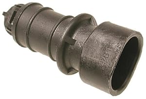

    i have a check engine light and it seems the air charge temp sensor is the cause can someone tell me where this is located? thanks

    theres a ait sensor, air intake temp. its in the air filter tube from the air filter to the TB close to the TB.

    dont have the code off hand got it read at advanced. i got a delphi ts10072
    never changed one before all i know is it says air charge temp sensor.
  4. #4 Re: air charge temp sensor
    thats a iat sensor, its in the filter tube, has a wire leading to it.
    pull the plug off, then pull it straight up and out of the tube. you can try cleaning the old one. they get gummed up.
    also check the wires to the ait. they get messed up, i had to change that pigtail as well as the maf pig tail on my car.

    yup thats it. thanks for saving me from hunting for it. ill try cleaning it i guess if i put a new one on and it doesnt help i will check out the pig tail going to it. i will try and stay possitive. thanks for your help
  6. #6 Re: air charge temp sensor
    no problem. check the wires for missing insulation, once its gone the wires also die, they get whats called dry wire. then the wire dont pass current right.

    question the issue was the pigtail someone had replaced the iat before im guessing the wires were rubbing against metal and rubbed through. i went to the junk yard just to get a new pigtail same some time and money but mine says ped 10 the one i got is ped 11 will it make a difference it came off a 3800 series motor
