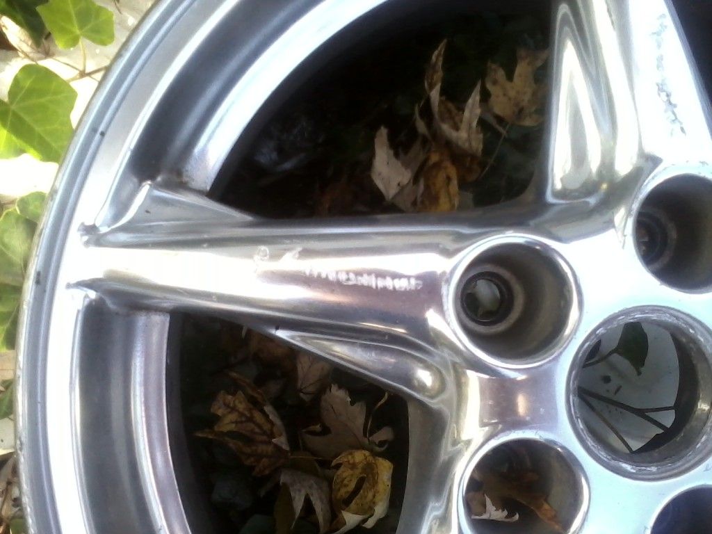

    Heres what I am trying to fix

    That looks like clear coat peeling and a nice scratch . You can do it just on that one but it'll be a lot shinier then the rest considering you'll strip the clear off that section and polish the aluminum .
    Aluminum with polish shinier then clear coat . But polished aluminum will dull faster then clear coated
    Polish and reclear and you should be golden if you do it right

    what it was the guy who took them off scraped that tire tool all around it because he did not put the hub on the rim while he had it on the machine they were perfect before that so yeah a deep scratch that took the clear coat off I don't mind doing the whole wheel actually I would rather re clearing it is fine with me I have a compressor and some clear coat already
