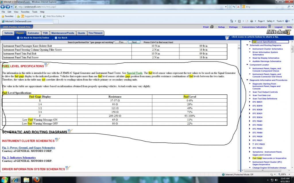

    if you have electrical knowledge and want to test the sender. here's the resistances.

    well you'll have to test the sender to see what the resistance is, if it's reading correctly it could be wiring or the gauge itself. the fun part is the fuel level sending unit is located in the tank...so i'm not sure where the easiest place to test would be...right at the gauge cluster perhaps but here's the diagram i found for the sensor...its in the tank..
