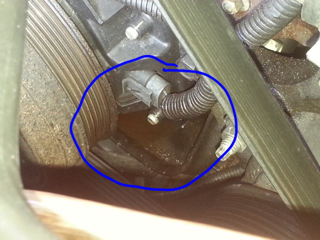

    Now I did find coolant all over the power steering pump when I was looking from underneath the car. See picture : http://i1127.photobucket.com/albums/...ps6b394c1f.png
    I cannot figure out where the coolant is coming from though. Someone said maybe the weep hole on the water pump. No clue where that is. Again, can't see that good even with mirror by the water pump.
    Anyone know where this coolant is coming from?

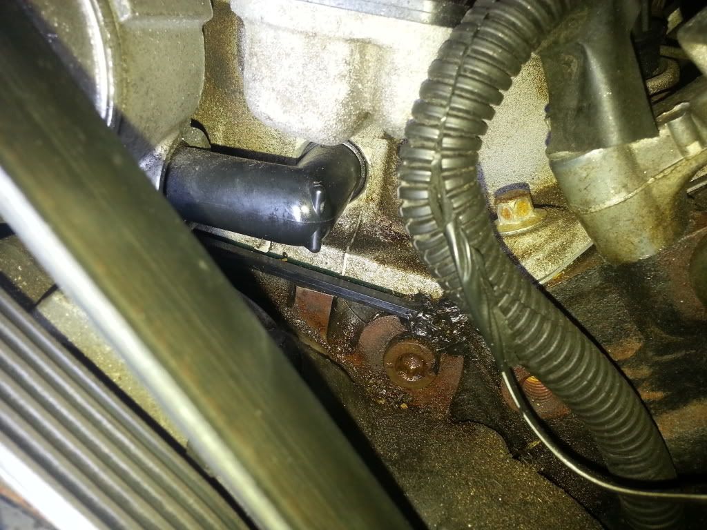

    I have NO idea where this coolant is coming from. The upper elbow look like it may be leaking, but im not sure. Its hard to tell, if it is its definitely not a fast leak. Maybe it only really starts to leak while I'm driving, lets say on the highway? IDK ??
    Even if it was the upper elbow how do i get coolant to puddle up on the skid plate and how did coolant get on the power steering pump?

    I took a piece of dry paper towel and stuffed it under the upper coolant elbow. I drove to the store and back and checked the paper towel. It wasn't soaked but it was partially damp. It kind of smelled like coolant, not sure how any other liquid could get up there.
    Here is a picture of the elbow before I took it out for the drive. http://i1127.photobucket.com/albums/...ps67a4c9aa.jpg

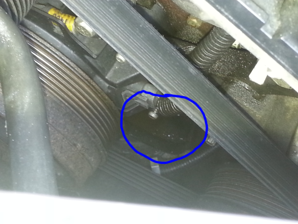

    Here is a couple pictures of where I can see coolant puddled up on the front skid plate. So I have coolant there and I found coolant underneath the power steering pump (picture in previous post)
    http://i1127.photobucket.com/albums/...ps302a062f.png
    http://i1127.photobucket.com/albums/...ps105231f3.png
    What do you guys think ??

    I think the pic in post one shows oil.
    I think these two pics show a moist motor mount, which is completely normal on a 3800.
    Are you honstly leaking coolant?
