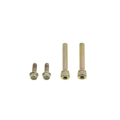

    39,929
    this is the pic on the site, this is the bolts, and sliders.

    1,604
    alright it makes more sense now
    this is what it looks like on my car hopefully i can just screw a new bolt in and be good to go
