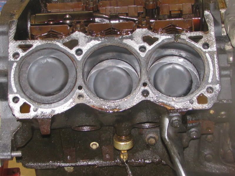

    Where is the knock sensor even located? And what spark plugs and wire are worth my time? Something long lasting i can rely on.
  10. #10 Re: Car is missing/lagging?
    stick your face under that car from the front.
    look up under the manifold/head it'll be next to the oil pan. the other one is on the opposite side in the same spot.
    Ac delco wires with either stock ac delco plugs or autolite 606's copper cores. Your pick, the coppers will only last 15k miles, they are cheaper and the car loves em, but again, they dont last the 75k-100k like AC delco plugs.

    When im feeling around for the knock sensor is there anything specific i should look for?

    Feel around the knock sensor and see if the wire is knocked off or anything.
