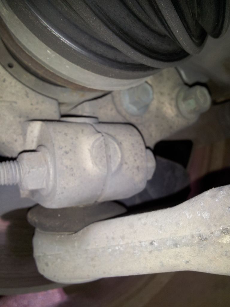

    I know this is a Grand Prix forum but I figure there must be someone here who can help. I own a 2005 Pontiac G6, it has 100k miles on it and we have been having alot of issues with the front end. Our warranty is now up and the front is needs work yet again. At highway speeds the car wobbles real bad especially going around turns. It's not like a bad balance on the tire wobble. It feels like the front end is going to drop. Also when turning the wheel I can hear the front end squeak which to me sounds like bad ball joints but my 96' Mustang had bad ball joints and it doesn't sound the same.

    get under the car and see what is broken. sounds like a sway bar or something is loose on the front end.

    Took a pic of this while under the car, this is on the driver side which looks to be part of the hub assembly? Not entirely sure. But was like this on both driver and passenger side. Don't think it's suppose to be cracked like this. Also the ball joints had no grease in them and the tie rod end boots was cracked to hell and missing chunks from the boot

    I'm sorry to hear of the troubles with your G6. Your issues may be caused by the hub assembly, tie rods or sway bar. It can be difficult to diagnose over the internet. I encourage you to take the vehicle in for an inspection. A certified technician should be able to offer a more accurate diagnosis after a physical inspection.
