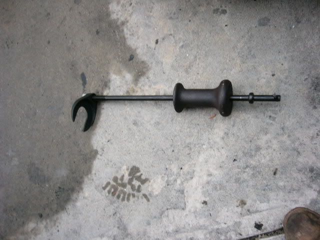

Well, tried the CV joint removal tool and no go, that driveshaft will NOT budge...any other ideas before I call a mechanic?
Is this the piece your using? It the best I've found as it lets you hook in nice and solid. I was dealing with a bad clip and ended up pulling the entire output shaft out of the transmission with the axle. Then just took a couple hits from the side with a hammer and they seperated.

Well, tried the CV joint removal tool...still will not budge...what the he11 is going on??!!
Thats the tool. It has to be a bad clip. He's afraid he may damage the tranny casing.
Gearwrench tool #82248 is the best tool I've found for the driverside axle. It allows you to adjust to any angle you need. Plus..if you ever see one, you'd understand that the axle is afraid of it.
