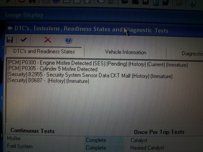

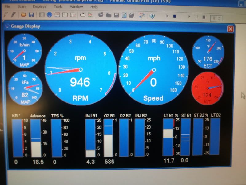

    Ok so I romped on it a few days ago and right after it ran really rough. Like it was completely missing a cylinder. When I first scanned it I had a bunch of different codes. (pic will be below). SES light is blinking. Now its saying cylinder 5 but I checked the wire and the plug and looked and it had a good spark. So any help with my problem would be appreciated guys. Thanks.
    First scan
    Second scan as of now
    If this gives any info.

    That P1362 on cylinder 2 bugs me. 5 and 2 are on the same coil pack. Swap coil packs with another and see if the misfire moves

    Googling 1362 and 1361, you have what appears to be a bigger issue than just a coil, plug wire. Maybe a bad ICM or wiring. I'd want to look at the diagnostic aids in Alldata or GM ESI to see what they suggest these to be caused by.
