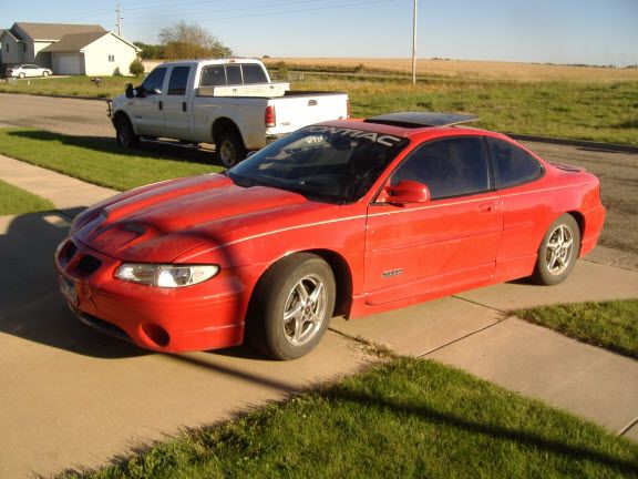

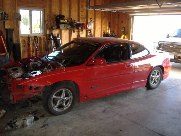

    This is the way i bought it 2300bucks!
    Came with
    -Short stack IC
    -ZZP ported GEN3
    -Stage 1 ZZP TB
    -PLOG, ported rear, 3inch DP
    -SLP loudmouth exhaust
    -XP cam
    -Double roller timing chain
    -KYB struts w/ B&G springs
    -F1 hood

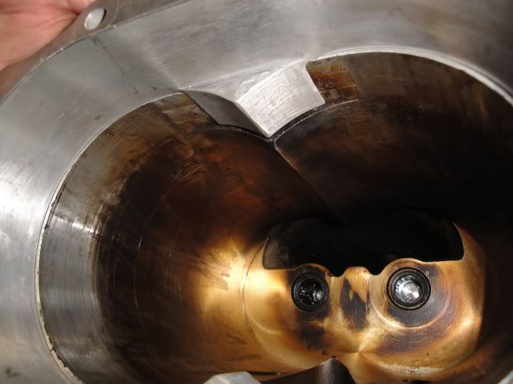

    Added a genV w/ 65# injectors and e85
    Finished in 1week after owning it to just drive it some.

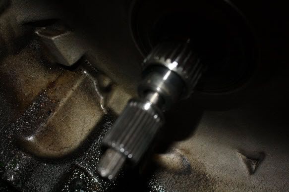

    After 2 scans and a little bit of tuning input shaft snapped on the trans!
    Got new trans in now with 7/8" chain w/ 3.29 grs with harden input shaft

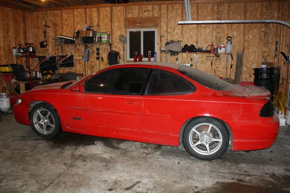

    Picked up some decent 17inch rims

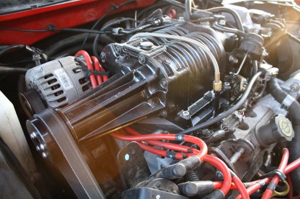

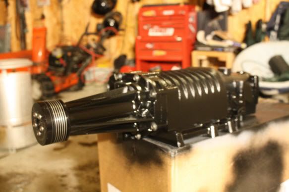

    Got bored and painted the GenV.

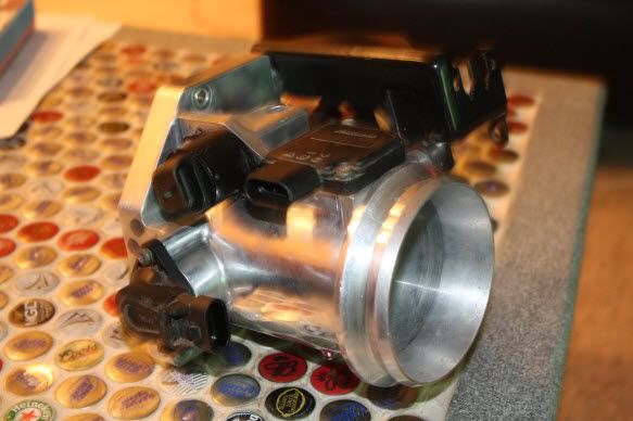

    And my purdy 78mm Billet TB to add to the genV

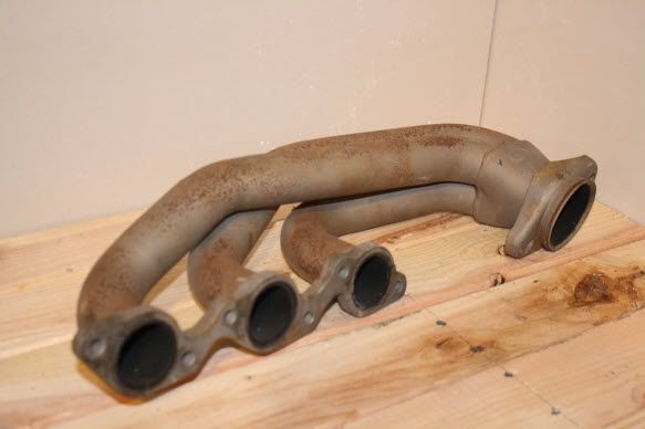

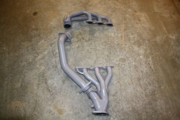

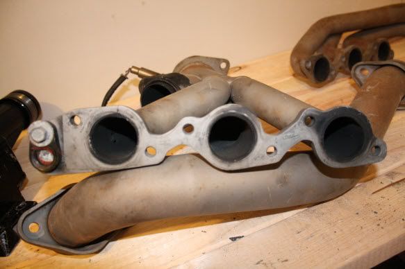

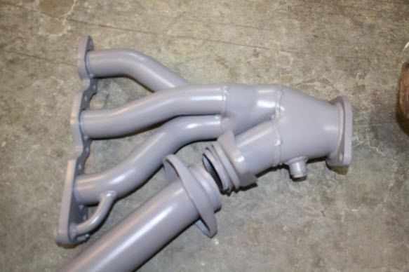

    Headers=TOG extremes!

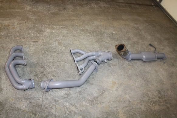

    Some high temp ceramic coating

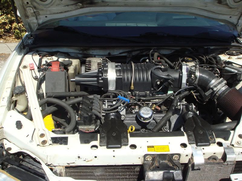

    genV m90 getting changed to m112 hybrid!
    It will look similar to this.
    Im working with a prototype engineer fab'n up the plate for me.

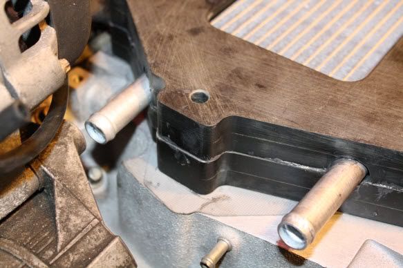

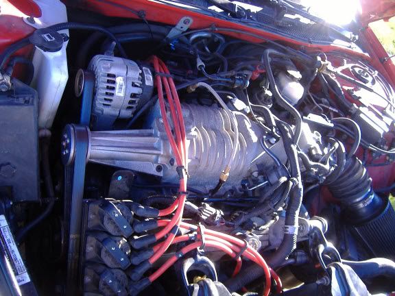

    GenV ic installed but ran into problems with VAC leaks by the IC and by the TB.
    Ran into a problem with the s/c belt hitting the back of the Coil paks. Nothing a few washers cant fix.
