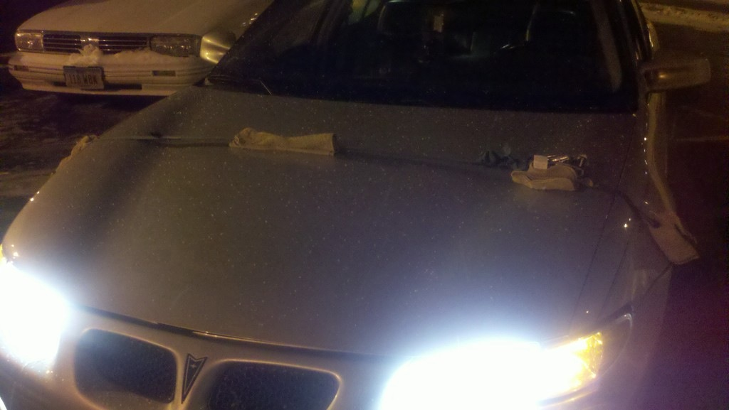

    This is what I'm working with right now and it's just a matter of time that igoing to mess up my paint
