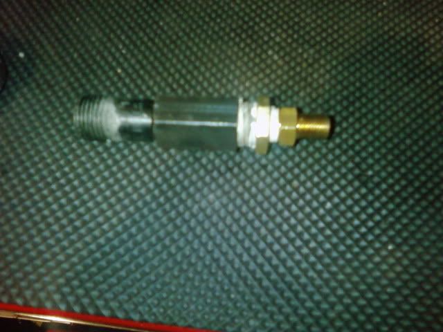

Couldn't think of a better or shorter title for this lol. Well Matt5112 wanted me to post this and share. I don't have exact part numbers or anything with me but I assembled this at my local parts store and so can YOU!
This piece in total was very cheap at roughly $5-6 to build. Its a 3 piece sealed with teflon tape (like every pipe-style joint should be). You can buy a hose that goes into your spark plug holes from the parts store and put on a tire fitting like I did but I have found that the hoses are more of a pain in the ass and are not guaranteed to work ever because a large majority of them are for BOTH sizes of spark plugs and since our heads have the spark plugs countersunk very deep you want JUST the size you need. If there is enough interest I could possibly get exact part numbers but at the moment I think that if you are going to be changing your own valve springs and seals you should be able to figure this one out from the pictures.![]()
