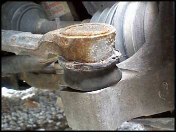

    I took a look behind the front wheels today and wondering if anyone can determine if these bushings look bad.
    The Passenger side:
    which didn't vary much to the untrained eye from the Driver side

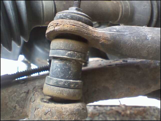

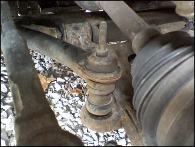

    also these joints (trailing arms?) looked to be a bit deteriorated, might this cause a noise in the suspension.

    first ones are sway bar links, and look alot like mine did when they made noise, the second pic is tie rod end, if those are bad you will get movement when you grab the wheel and wiggle it (unlock the column first)
