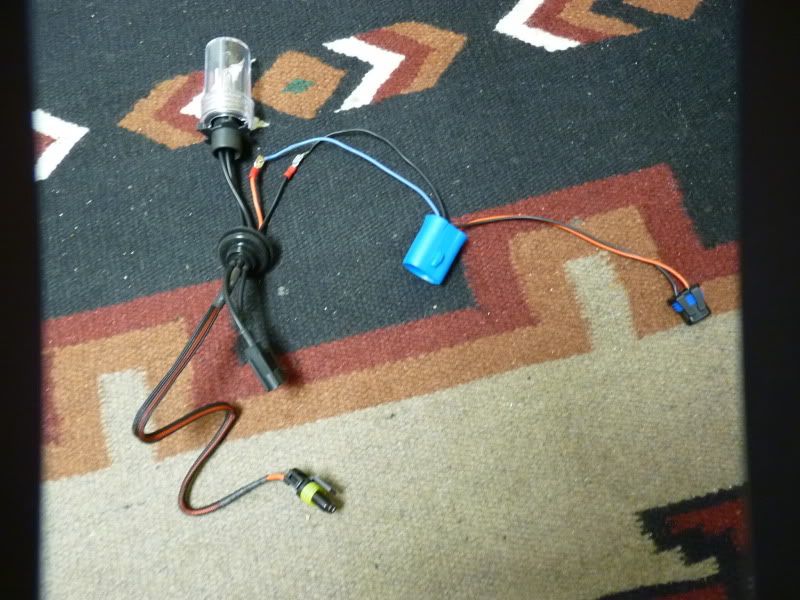

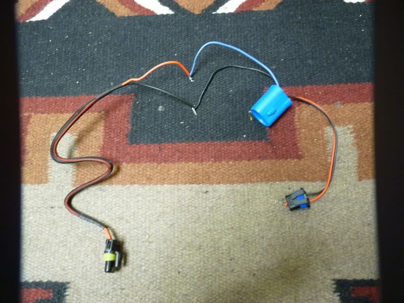

  3. #23 Re: Projector HID
    GTP Level Member BlownBigBlock's Avatar
    Apr 2009
    Carlisle PA
    547
    I did it both ways... The top picture is how it would be if you didn't pull the wires thru (I had already cut the female spade connectores on the the blue/black wires). Then second picture shows I removed the ballast power wire from the rubber plug in the first picture and just connected the directly to the blue/black wire. The plug with the yellow
    insulator would get plugged into your ballast.

  11. #31 Re: Projector HID
    Specialist Walter US Army Spartan GL's Avatar
    Dec 2009
    Largo, Florida, United States
    2,907
    Roca
    Those spades go into two different Plugs
    The Black Spade goes into the BLACK WIRE that is feeding through the Rubber Cone thing and Connected to the Outside of the Frame (Near where the Bulb is.
    And the Blue One goes into the Red wire That is Connected to the STOCK BLUB
    plug and play too easy
