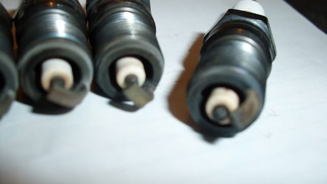

    its like the tip kind of melted away. ill have pics soon.

    Im assuming you mean the electrode end, the end that goes in the motor.
    Check here and see which one is closer to what yours looks like. Hopefully it will help you pin down the issue.

    yea the electrode end. kind of looks like the one that says melted, but worse. i have over heated a few times, wonder if this would be the cause. i think im leaking coolent but dont know where, that will be another thread.

    how is your fuel ratio? running lean will get a motor pretty hot and do a number on the pistons and plugs.

    and i dont think i can get pics up, the camera will not allow me to get close enough to take a good picture (blurry) but it looks like the melted plug on the link posted above.

    thats the best i could get, still not the best tho.

    youve never tuned your car with all the breathing mods you have. youre running lean or an injector took a dump on you.
    have you been running all this time without a scanner?

    Damn dude. Yeah, you need some kind of scanner to at least get a window into what is going on. I would think the injector for that cylinder may be faulty. The other plugs look okay, maybe alittle on the lean side, but that is what mine usually look like. You may have gotten a defective plug? I have seen some autotaps on the sale boards pretty cheap. That is the second thing I bought after an air intake.
