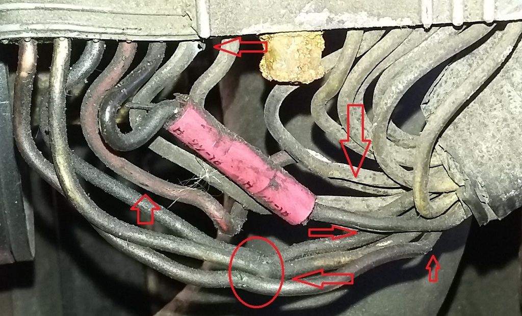

    During one of my stare sessions, where I just stare at the engine and poke around, I noticed the wiring on the ICM is looking shody. Lots of cracks and at least 3 areas where wire is clearly visible. How would I go about repairing this?
    I'm thinking of finding a junk-yard harness, cutting the wires, and taking that home. Cut wires on one end, and the ICM connector on the other. I would then cut those wires off of my harness. I would cut that bundle of wires closer to where the motor mount (dog bone) bracket is and soldering in the newer wires into my harness... Any thought's?

    Do not cut and solder any ICM wires. The ICM harness should just be replaced. Don't take a chance.
    Rockauto has it for $81 before shipping.

    Ok. Cool. Thanks for the tip, Silver2k! Didn't know that buying just that piece of the harness was even an option. Sounds good to me. Looks like I will be buying that soon.
