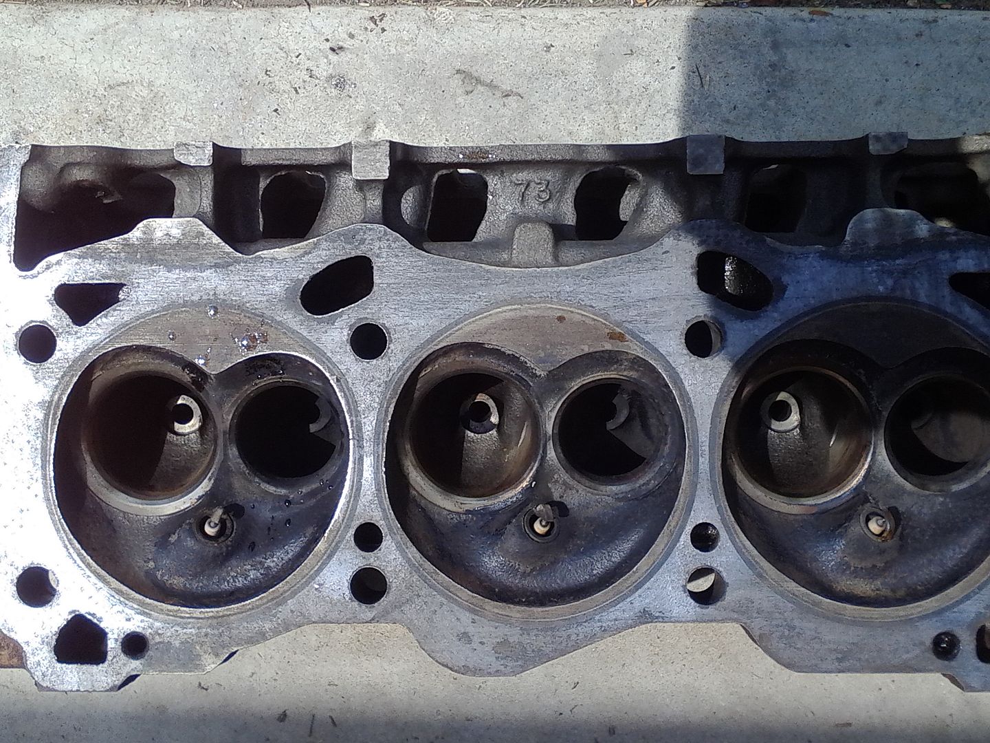

this was before cleaning/scraping the deck, i was cleaning the piston tops of carbon.
http://i1097.photobucket.com/albums/...pssfzanbck.jpg
and the head before cleaning
http://i1097.photobucket.com/albums/...psrts19bum.jpg
all cleaned up. ported, polished. put about 18-20 hrs into them.
http://i1097.photobucket.com/albums/...psdbo0tpuj.jpg
even if you were to just polish them and make then smooth inside is a vast improvement.

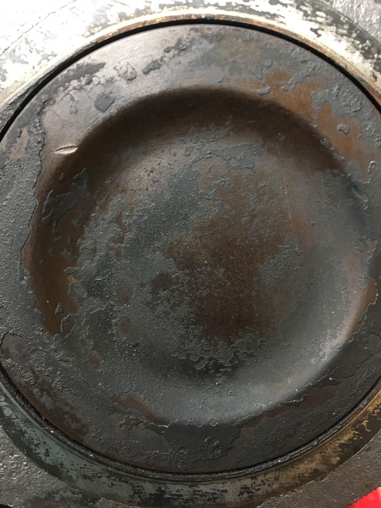

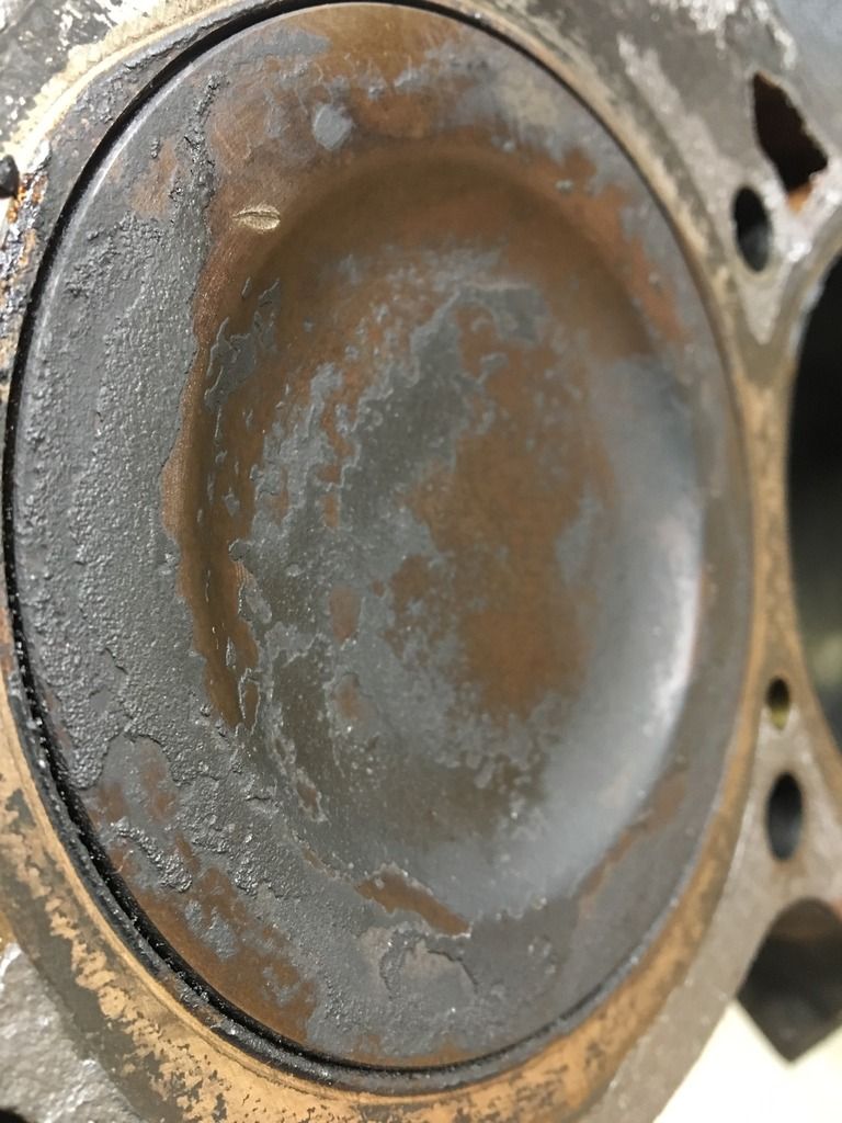

hows that spring looking? som-bishh hit the piston.
needs a valve job at min id think at this point. see if the valve stem is bent too.

I was wondering what that nick was
Re: Cam install, need advice leaking exhaust valve?

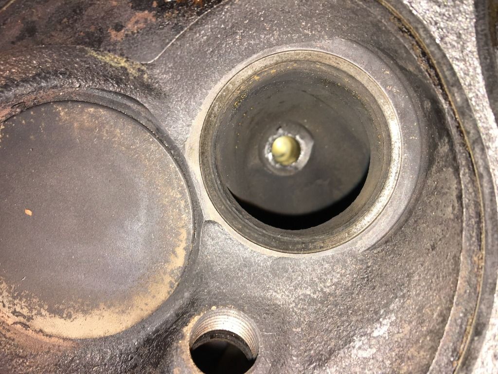

Spring got mixed up with the others when I put the 90#s on. The valve looks perfectly straight but it must be bent juuusst enough to cause a leak. So new valves and valve job? Should I mill the heads flat? Alum heads? Lol
I would consider getting the heads milled, but it will raise the compression ratio, so you might have to run a bigger pulley or higher octane fuel. a valve job for sure.

you just installed the cam right? a stock spring should not let the valve hit. cause by the looks of that piston that valve has been messed up for a long time.
take it too a shop, ask for their recommendation of what to do with it. maybe they will fix the one valve seat. but im sure they would want to do all of them. it maybe best to do both heads too if they say this one needs a full rebuild.
The new cam isn't in yet I was about to put it in when I discovered the leaky valve. How else could it hit the valve?
