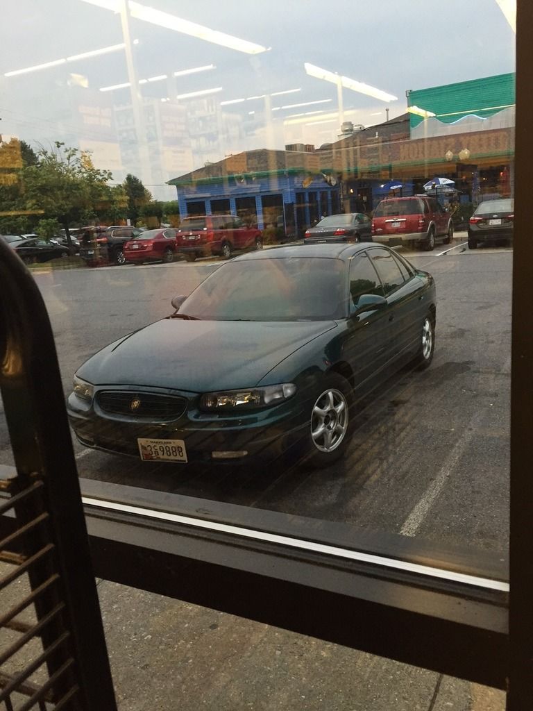

    Here's my car, its been a great beater. Got it with 66k miles from an old lady about a year ago to replace my GTP. Never had an issue with this ride other than this. I am planning to top swap soon, but want to iron out this issue first.
