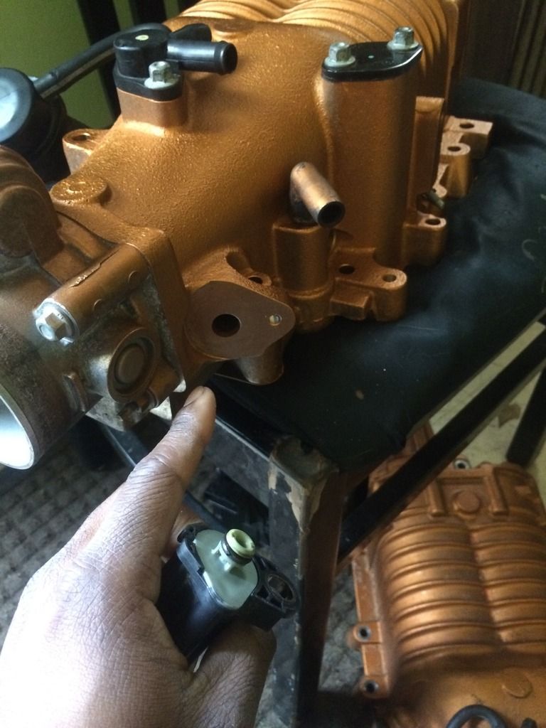

    Update! Ok did some painting for the little bro and ran across a missing sensor on the back of the Supercharger. This may have been the cause of the codes and huge vacuum leak that caused all the horrible idling and stalling
  11. #51 Re: Car just cranking and not starting after Engine install.
    That's the evap sensor. and ... hey the leak was about the same size as the booster..lol
