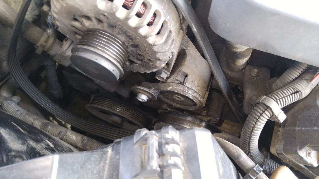

Was gonna switch out my idler pulley on the GT2, but after it came off like an absolute bare...., found the bolt threads were kinda crapped on the bolt, and the threads in the tensioner thing were crapped out. And, the idler pulley had already been replaced, so, guessing someone fricked it up when they put it back together. Ugh. So, guessing '99+ Series II N/A is the same as Series III N/A? Hoping so, as the local yard doesn't have any Series III engines. I'm also guessing that S/C'd car's ones are different...?
http://i356.photobucket.com/albums/o...psjqv5mppo.jpg

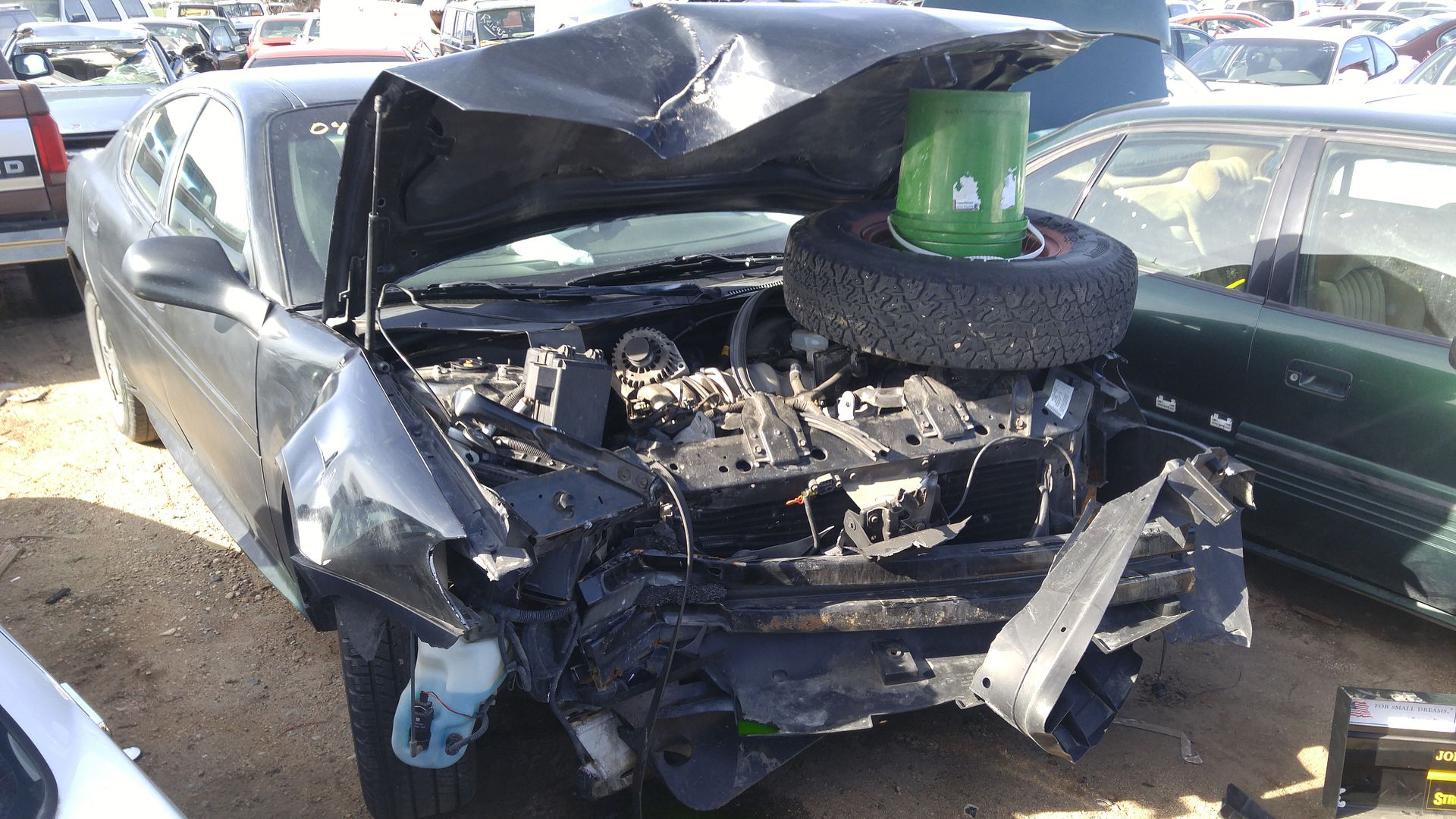

Well, I was in luck, local yard just got a 7th gen in. Engine was kinda shoved into the firewall, but got the whole assembly there off.
http://i356.photobucket.com/albums/o...pslvdforko.jpg

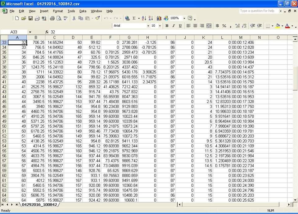

Yeah it ran ok the first pass. Had a decent amount of KR in the burnout and launch. Figured meh.
Did a few more passes .. the cutout was open.. couldn't hear ****.. car went from a 13.5 to a 14.5. Hmm. Came back to the pits and buddy said that doesn't sound right. I closed the cutout and anything above 1800 rpm's it rattles. Bearing is done. Oil looks like glitter on the dip stick.
here's a screen shot of the pass :) Column L is KR :)
http://i283.photobucket.com/albums/k...psofcwrkbf.jpg
Something with the torque management wasn't turned off. It didn't have any KR on the street. Oh well.. **** happens.
