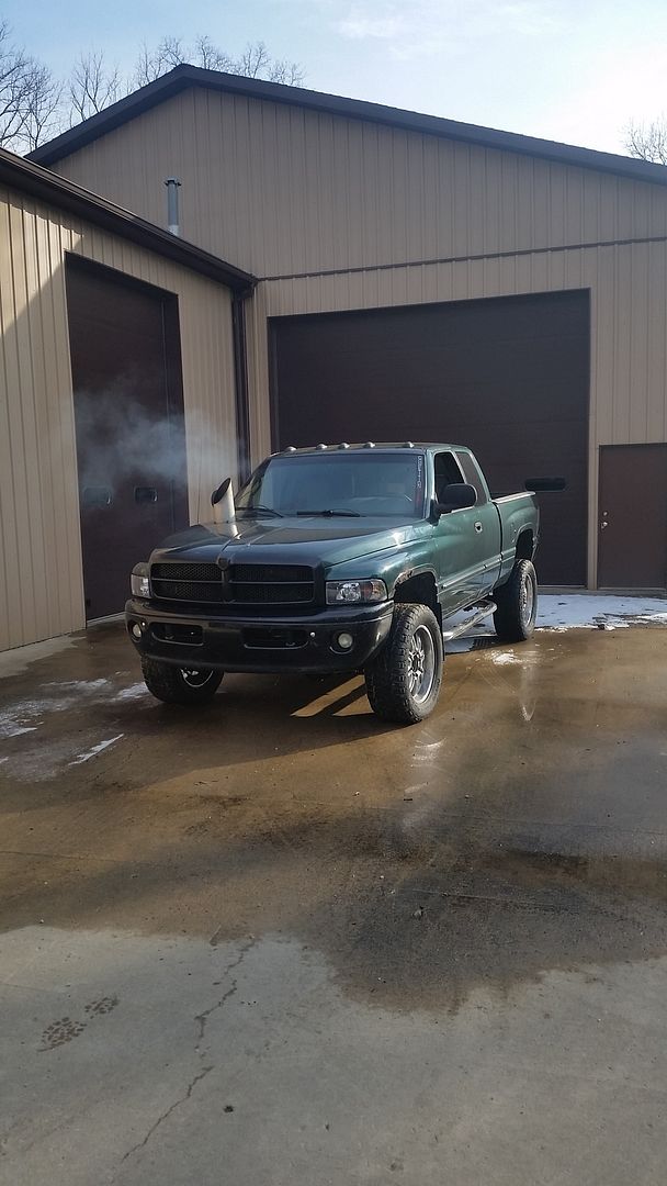

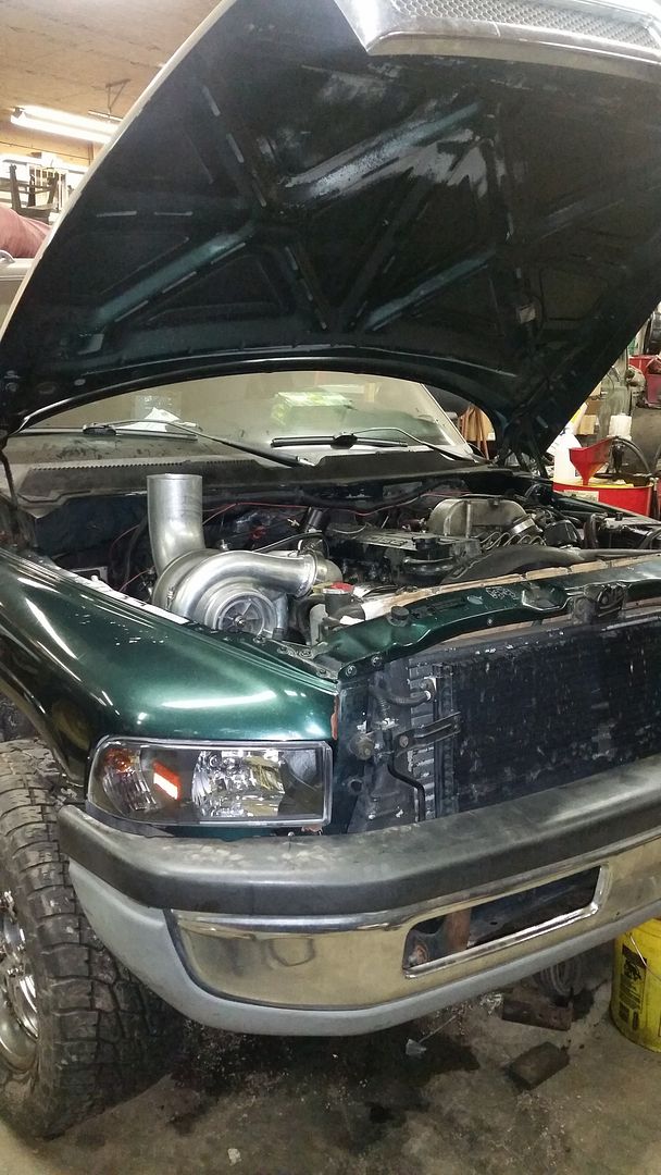

p-pumped 24v. with a decent sized set of compounds. should make around 1k and hopefully run 10s if the trans cooperates.

That's creeping toward 1,000HP?
Whats been done to it ?
stock long block except for head studs and valve springs are the only actual engine work. large injectors (6x.018 are the nozzle size. flow approx. 3.5 lpm), the injection pump (pump is off of 96-98 12v cummins, 600cc's of fuel flow) and the compounds (s366/68 with a .91 t4 hot side and an 88/99 1.15 t6) are all it takes. have a ridiculous amount of money into the auto trans. y'all complain about the 4t60e being a glass trans. try a 47re some time with billet parts.
