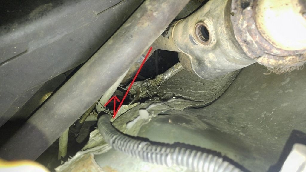

    Quote Originally Posted by ScottyDoggs View Post
    re rout your o2 harness. another header melt down.
    you need a new o2 sensor too, that things form the factory.
    So, I won't be fine re-routing it up along the firewall? The guy had it like wrapped around the headers/DP. :S
    Nice..., where's the cheapest place to get one?
    06 LaCrosse 57-79k sold;99 4dr GTP 134-138k sold;98 2dr GTP 183k parted;98 Regal 166-184k;04 GT2 204-206k sold;04 GTP 170-175k sold;09.5 G8 GT Sport 145k;09 G8 78-84k+;08 Prix 164k sold;06 Prix 168k sold;02 Regal 92k;09 G8 103k parted;04 GTP SpEd 139k parted;04 GTP 205k;'09 G8 105k parted;06 Prix 230k;04 CompG 138k
  3. #5023 Re: What did you do to your Car today? Vol 2.0
    rockauto will likely be the cheapest place to find a o2 sensor. add a code at check out makes shipping free. or advance auto on line and local pick up if your on a time crunch.
    i cut the o2 plug off my cars harness, and added 3 foot of wire to it. ran the wire down the strut tower to the rack then right to the o2, nothing hot in the way.
  4. #5024 Re: What did you do to your Car today? Vol 2.0
    oh, get a delco o2 sensor too.

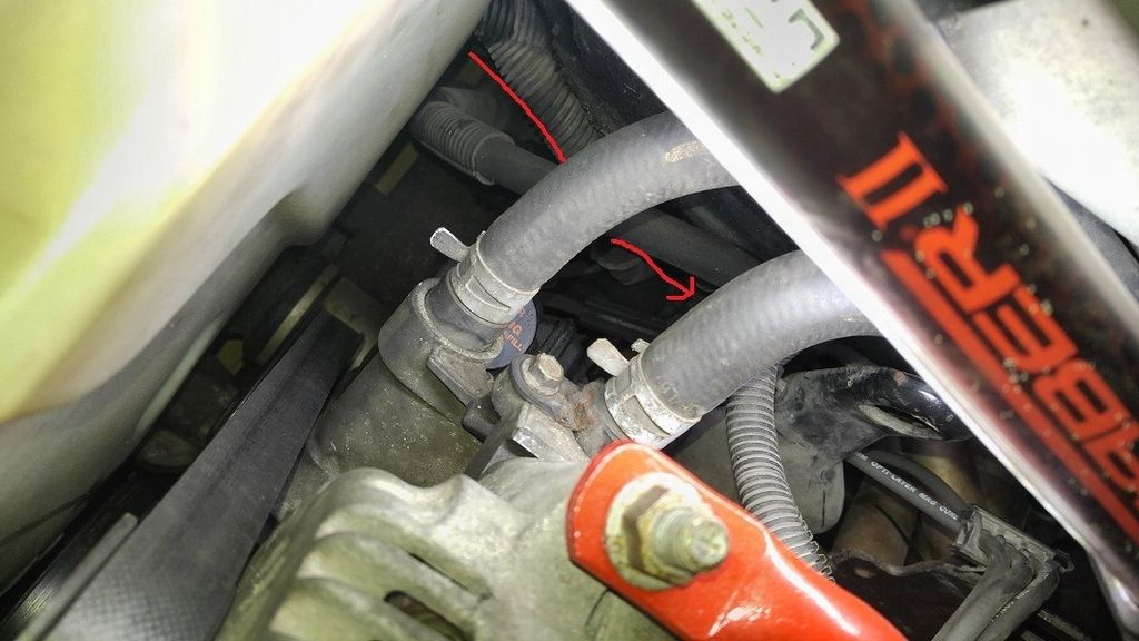

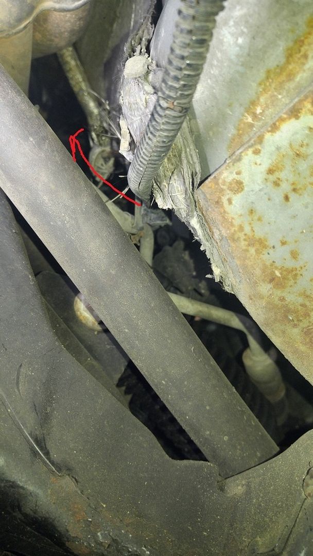

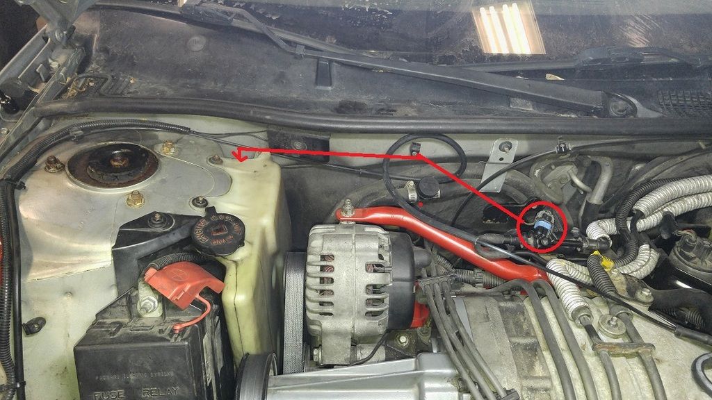

    Advance doesn't seem to have Delco's, Rock Auto does though for $37: https://www.rockauto.com/catalog/mor...id=433&jpid=10
    eBay has Delco's for $30: http://www.ebay.com/itm/NEW-AC-DELCO...VUnaG1&vxp=mtr
    So, I should run it like this:
  7. #5027 Re: What did you do to your Car today? Vol 2.0
    yup you got it. you can zip tie it tot he fire wall, run it a top the sway bar to the o2 wire. seems like a no brainer to me. not sure why other have not done it this way more often.
  8. #5028 Re: What did you do to your Car today? Vol 2.0
    GTP Level Member Kaiser Pontiac's Avatar
    Jun 2015
    Land of 10,000 Salted Roads and Rusty Cars.
    866
    Sweet, thanks! I'll grab some more loom from work to make it look pretty and some wire, get a male connector from the JY, and throw it all together.
  9. #5029 Re: What did you do to your Car today? Vol 2.0
    what plug? you leave a few inches of wire on the cars harness o2 plug, then extend it.
    the wires off the o2 sensor, one is stainless steel, solder wont stick to it. so making it longer from the o2 dont work out well.
    make sure you solder and shrink tube the splices.
