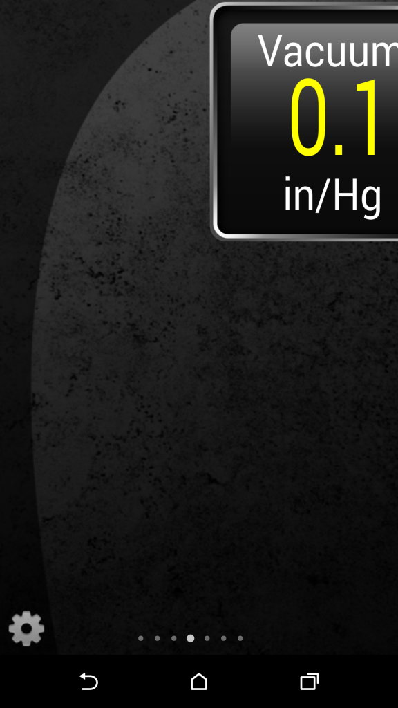

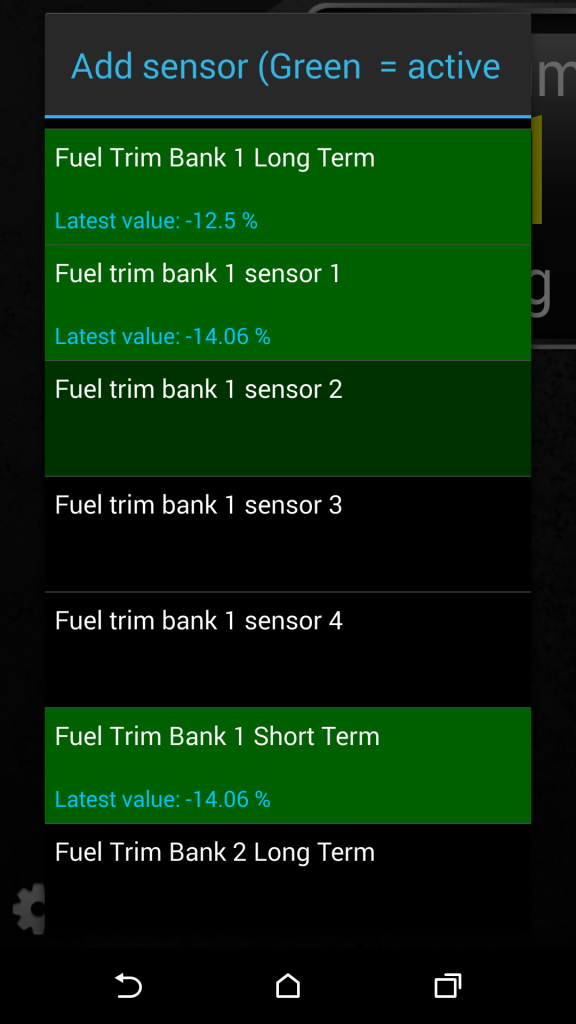

    Ok little brother car is having problems. Recently did an manifold job and everything went down hill from there.
    So here we are. Problems are that plugs are wet with gas, car is misfiring badly on all cylinders. Huge vac leak. I think it's reading 0.4 at idle. So we are trying to find out where to start.
    Also four of the injectors pulses aren't reading on my torque app. I'm going to screenshot it and post it here. Thanks guys
    So what the hell is going on. Trying to help him out

    If you have a huge vacuum leak, the computer will dump more fuel in. So.find the vac leak and then see. Also. Torque app only reads 2 sets of injector pulses. Do you have an ses light on?
