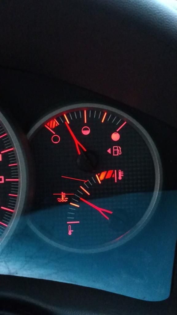

    This is a picture of my normal temp while i'm driving and above it "red line" that is where my temp will climb up to until the fan's will kick on which bring it back down to normal temp. I would say it takes about 5 minutes or so for it to reach the temp before fan's kick on "I think" Does this seem normal to you guys or do you think my car has some kind of heating problem?
    Btw the thermostat I have is a Fail/Safe 180"

    you could have some air trapped. but it also could just be normal, all these engines drive cooler vs when they sit. that top line is your 210 line, thats where GM engines like to be.

    I agree. That is a pretty normal. I have an 04 and I had been having temp problems for the longest until recently when I had to do a head gasket swap. I would recommend replacing those plastic elbows with the aluminum ones and making sure you bleed the system very thoroughly. You do that by taking the tstat housing off and filling up the LIM through there. Once you have enough coolant in there, put the housing back on, fill up and top off your radiator. Once the radiator is topped off, leave the cap off, open your bleeder valve, turn on your car, put your heater on full blast and let it get up to running temp. Check your upper and radiator hoses, once they both feel equally hot it means your tstat opended up. Constantly squeeze your hoses to get those air bubbles out and fill up the radiator as needed. Once you see a steady stream of coolant shooting out of the bleeder valve and you are getting some pretty good heat inside the car, close the valve, put the cap on the radiator and you should be good to go.
