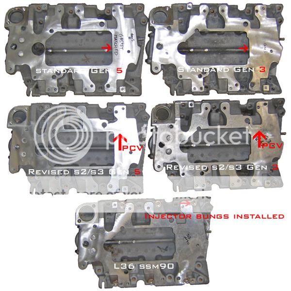

    Yes, Same core I got. Not entirely sure who made it, but it fits, looks good, and works.
    just FYI, the REAR PCV works, but the FRONT IS BLOCKED. You will need to run a breather, or tap the front PCV for the "WBS" core.
    No, I got a different core than you and what wbodystore shows, that's why I was asking. Yours is shown in the 2nd section with the notches milled out n stuff. I got the zzp core or w.e instead n ordered from wbs. So the front pcv should work just fine with this one. So I'm happy. Lol
    (still waiting on your write up) haha

    I bought an aero force from them n that's about it, n I'm happy I got the zzp core. Now I don't have to run a valve cover breather n deal with that vacuum leak.

    Not sure what the deal between WBS and ZZP but I have ordered from WBS and the package came from the town in MI where ZZP is. Pretty sure ZZP machines the stuff for WBS and drop ships for them.
    Looks like ZZP intercooler without the front hole / passage drilled. Without the ZZP manifold you still have to run the front breather.

    Most people don't realize it but you have to drill a hole in back for PCV for all intercoolers.
