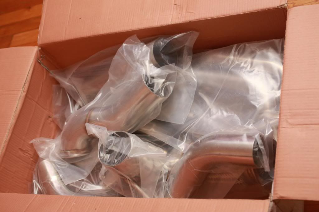

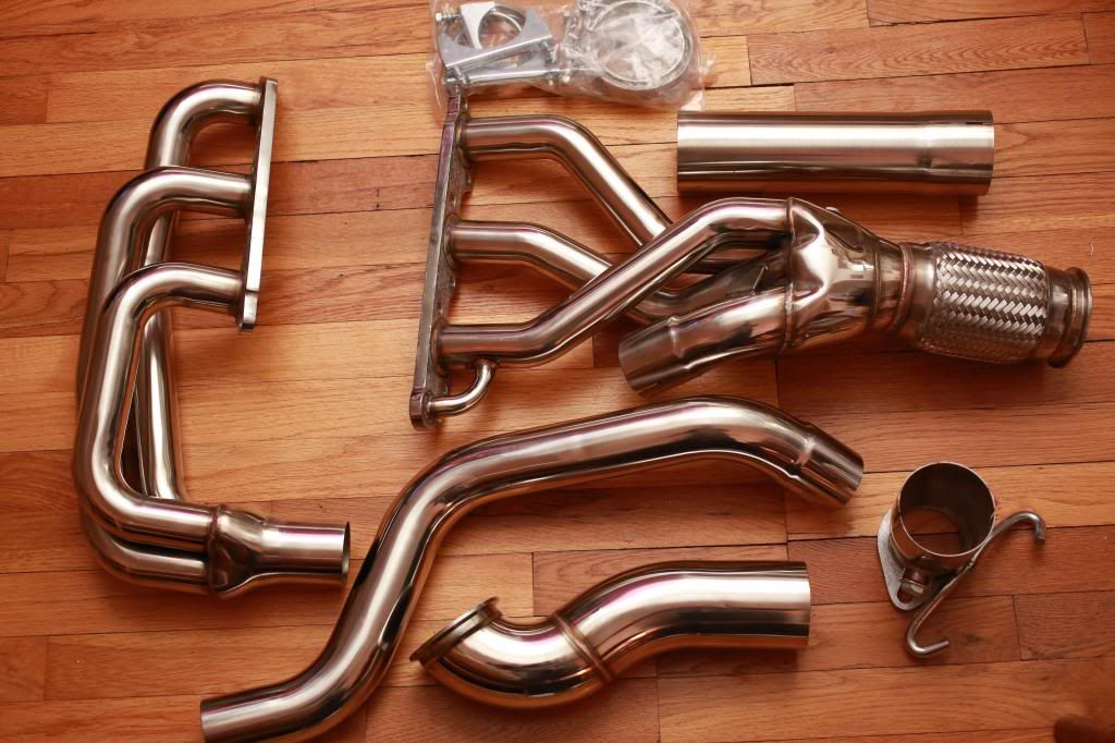

So here we are! Overall the welds, primaries, flanges, etc, etc.... are DECENT for $217 shipped.
I would have no complaints... and as I did in 2008, I would install these on my car WITHOUT MODIFICATION and have no issues!
On to the pics :)

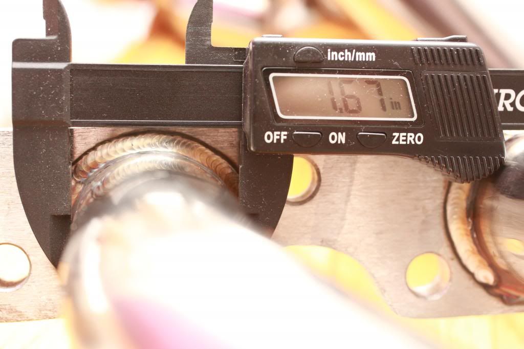

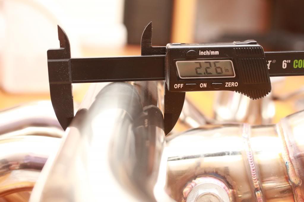

Primaries 1 5/8"
http://i201.photobucket.com/albums/a...ps78868e0c.jpg
Crossover 2 1/4"
http://i201.photobucket.com/albums/a...psc5cf24ef.jpg

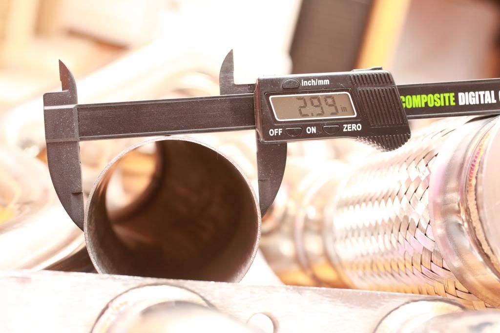

Downpipe 3"
http://i201.photobucket.com/albums/a...pse0f011f2.jpg

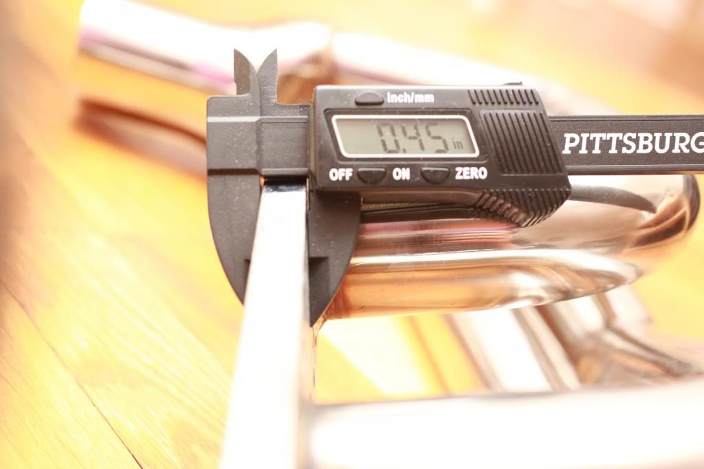

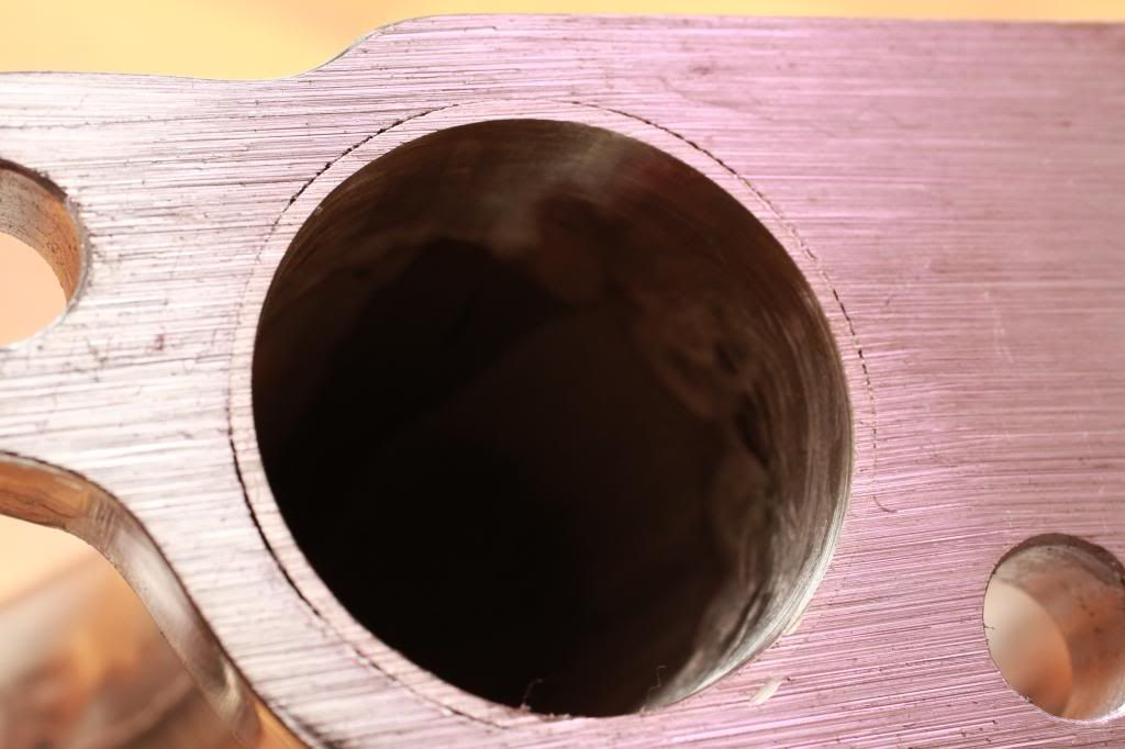

Flange 7/16" nearly 1/2! (WBS claims 3/8th, I wonder if they ever measured...)
http://i201.photobucket.com/albums/a...psb3f19d45.jpg

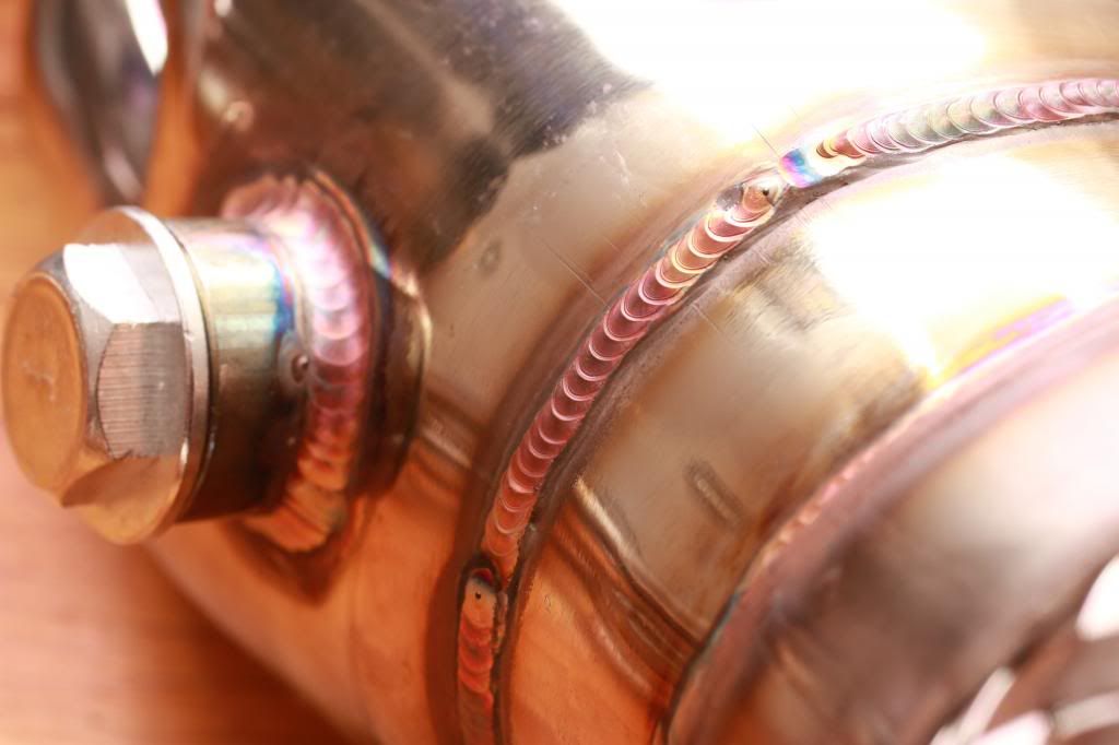

looks like speed daddy found a Chinese kid who could weld lol
construction wise they look 10 X better then wbs headers.
DNA Motoring (Speed Daddy) told me that they QC each unit they sell, and that they do get bad ones from time to time... but those go back to the manufacturer and they only ship the nice ones.
seems some have forgot that small detail. dont sell the crappy ones lol
thoese are pretty slick looking for Ebay headers
That's how mine looked when I got them.

Let me be clear... these are NOT awesome super fantabulous headers.
These are $217 (retail) headers from China.

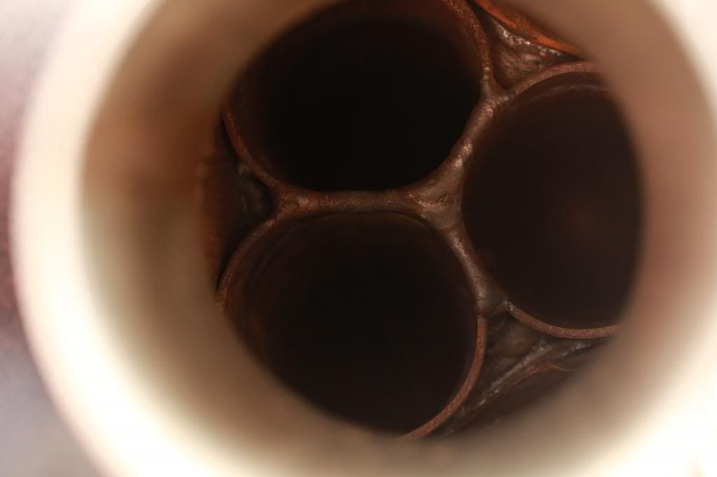

There are inherent design flaws such as the less than perfect 4-1 collector.
With that said, for $217 there is NO REASON AT ALL to buy anything less than ZZP headers for more money.
These will install WITHOUT ISSUE. At the most you can upgrade the to band clamps on the crossover.
To pay 3x more money for THIS SET OF HEADERS with the flex moved to the downpipe is ludicrous.

is it me or does it look like cylinder 4's primary dumps right into the side of the 4 into 1 merge....yeesh

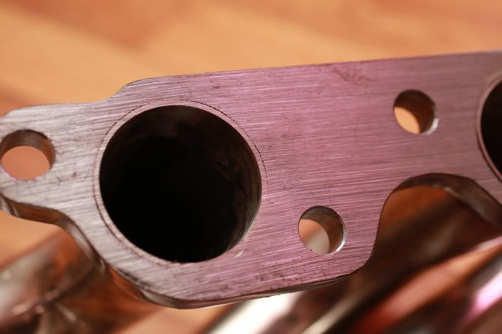

god it pisses me off when they hit the flange against a belt sander like that....most of the time they aint flat....
