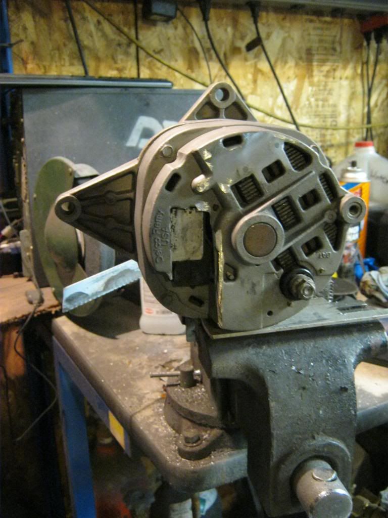

    Well..Since James let the cat out of the bag. Having had the 97 Bonne in my past, I wasn't happy with the alt output at the reading which IIRC comes from the ICM/PCM. Adding the S or "sense" wire is a great add on. As for Gen V'ing with IC. I did swap over before I had IC'd just because. However.. here's a few pics of Gen V with that alt and some of the modification needed.
    How it sits
    Cleaned up the bolts that stick out of the casing.
    PS ...you don't need to remove the bracket to change a rear valve cover gasket.

    btw bill
    the sweetest horizontal bolt bracket is to get one for the 99 F body
    BOTH elbows are replaceable unlike the integral 1" Oring bracket on the W's/early Fbody
    ~James~ Psychotic Gearhead

    James.. Nice to know.. thanks. On the newer alts where the output post is in the way of the Gen V, simply pull the back off, pull the spacer off the long stud that is the output post and cut it down.. then put the nut on and cut the post down. Presto.. a little plastic backing work and you clear perfectly.
    on that bugger ive just left the lower nut off (sleeve loose) and reinstalled, clears the plastic without trimming. thankfully everyone i end up helping are at least decent wrenches and can be trusted with odd ****/compromises
