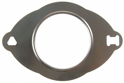

    Ok I know where the exhaust leak is. It's right under my feet because I can hear it and its ANNOYING! Ok so i had it done once before but they didn't do a good job. This is the gasket I need correct?
    But my question what are the shapes on the side? Are those bolts?

    Which downpipe do you have?
    The shapes help hold the gasket in place.

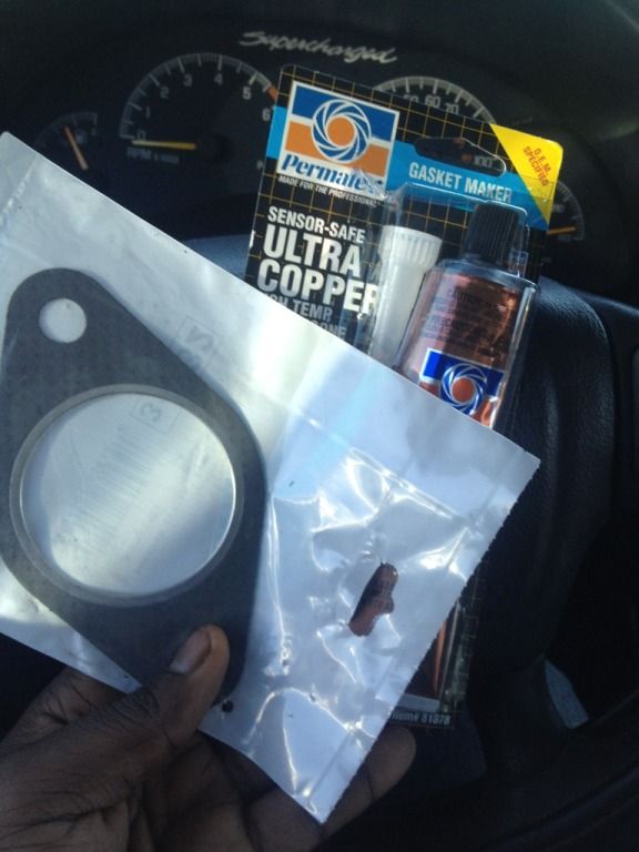

    I have a zzp Downpipe. Could I use this one?
  4. #4 Re: Need help with exhaust leak
    Use anything you want. You should know something about most ZZP pipes I've encounted, hence the question of which pipe do you have.
    Typically the crush zone of the gasket is inside of the ZZP flange and does not get crushed, which is why you don't seal. Take your current gasket and a tube of copper RTV. Wipe your current gasket off with brake clean (if it's metal) and goop the heck out of one side. Put that side against the manifold. Now reach down and goop the hell out of the other side with your finger. Put downpipe in place and torque down. Give it 45 minutes to setup and cure.

    Np.. did one the other day. Sealed like a champ.

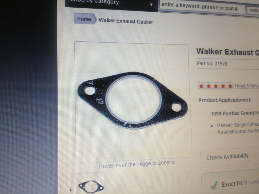

    Two different locations.
    By your feet and the first gasket you showed us is the DB to exhaust manifold gasket.
    The gasket you bought and the Ubend are under your butthole.
    Now if a bolt is missing at the ubend delete, you need a new bolt and the gasket with a little RTV. It's different that the other gasket.

    Ok yea I need the one by my feet. Dammit I just tossed the receipt. Time to go trash digging lol. What is the name of the other gasket? I think it needs to be ordered from a local part store correct?
  17. #17 Re: Need help with exhaust leak
    Here's the name of that gasket. LOL

    Flange gasket right? Lol. I'm having a hard time with these autozone associates smh.
  20. #20 Re: Need help with exhaust leak
    find a napa, they know better for real. auto zone didn't even have a listing for the cat back gasket i needed.
