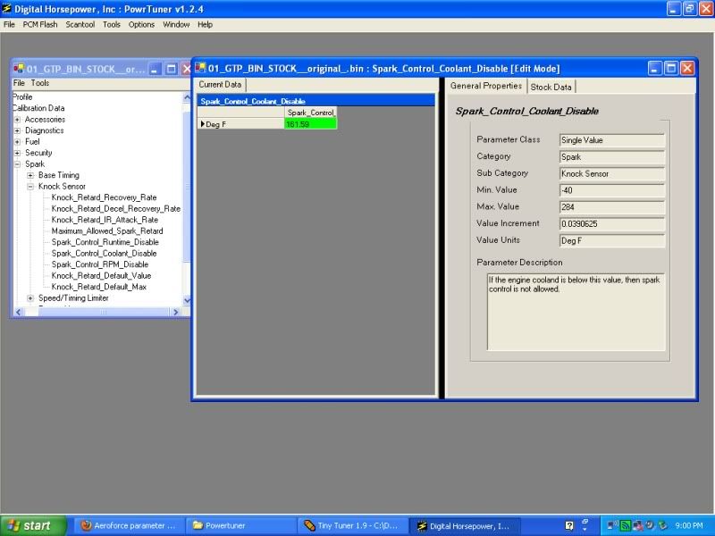

    I posted a comment on youtube about how the knock sensors on our car don't turn on until 160* and there are a few guys on there saying that i'm not right and they turn on as soon as you turn the key and they are always on. I know I'm right i just need you guys to confirm it so I can prove these kids wrong. Thanks

    this is true, In the PCM a stock Knock Sensor dosent recgonize KR untill the Temp reaches a certain point. OEM they turn on at 160*. Every tune that i do i enable the Sensor to come on @ 100 *

    I'm bumping this because this clown still doesn't believe that on a stock tune the thermostat doesn't turn on til 160*

    link dan .......linkkkkk... im in teh trollin mood

    lol i added to it

    It just won't attack the spark.

    well cant argue that, there is your answer!
