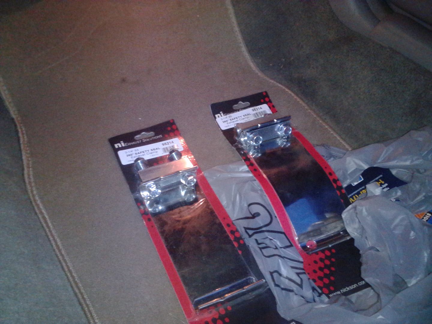

me. picked up 2 band clamps for the header install.
