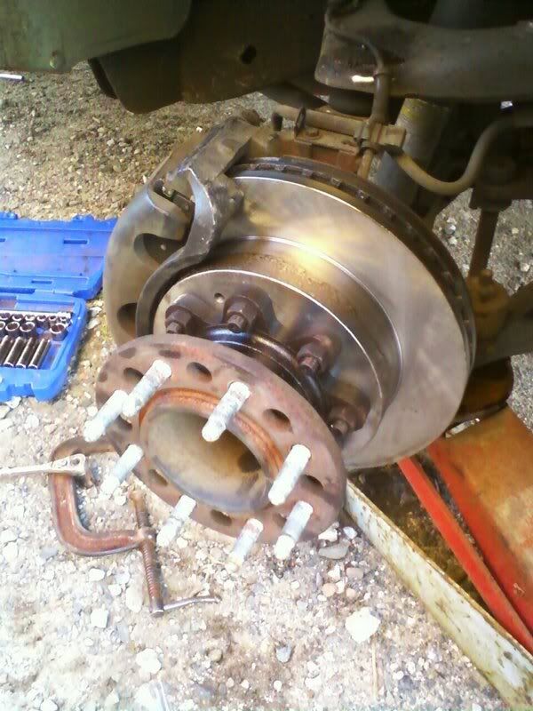

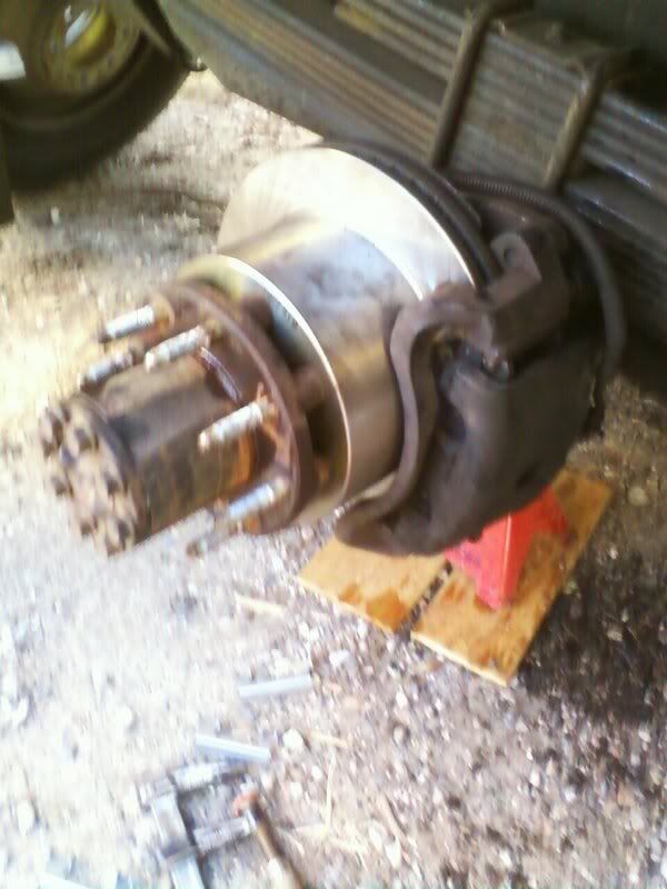

    spent most of the day at my friends house with him helping me change all 4 rotors and pads on his 06 3500 Chevy dump truck. we really both thought that the rotors would just slide off, but boy were we wrong.
    we started on the rears, turns out we had to remove the axle (full floating rear end) pull a clip, then a keeper key way, then remove a castle nut of sorts, then the whole damn hub came off. then we had to pound out the studs to get the rotor off the hub.
    the fronts had the same kind of hub extension that bolt through the rotor and to the hub, lots of big bolts to deal with.
    we got one side done, tomorrow we wrap it up.
    oh and i think i got the new big bad bake thread here dual piston front and rear on this truck too.

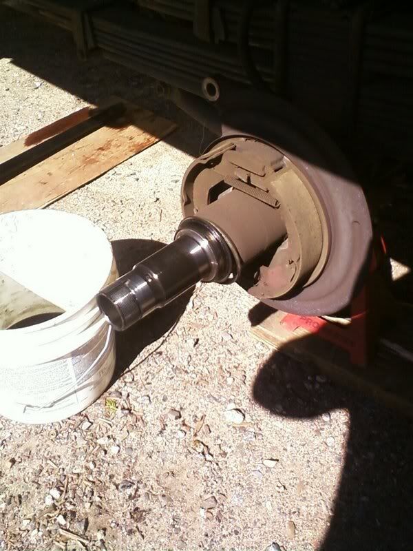

    finished that brake job, thought i'd share a pic of the rear hub rotor and axle removed.
    [IMG][/IMG]
    those shoes you see are the E brake, bigger than most cars with drum brakes.

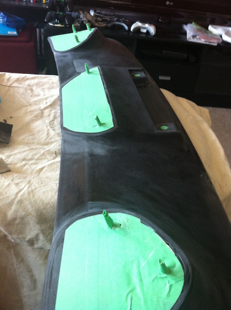

    started in on this

    what is this?
    started in on this

    GXP spoiler.. now that its not winter, its getting worked on!
