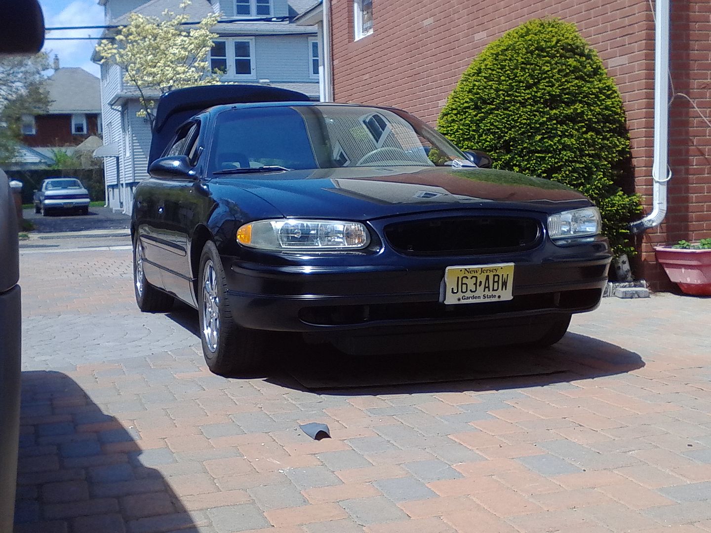

finished my front bumper re paint job. came out pretty damn good once again. this is wet sanded with 1000 and buffed with the good old HF buffer.
http://i1097.photobucket.com/albums/...ps22a89b0d.jpg
and the cherry back on.... the grill.
http://i1097.photobucket.com/albums/...ps158a66b8.jpg
i just need them fog lights to get here to finish the front off.
i played with the back bumper, the top got all rough feeling, so wet sanded it with 1000 and buffed it, and black was on the pad, clearly i lost the clear coat. so the top 1/2 will be getting repainted and cleared in the near future.

thanks man. you know its just to easy to not try it out. once again, less then 50 bucks. a paint shop would want a couple hundred easy.
i know a lot of us have the missing clear coat on the bumper tops, like i did, and the fail to shine no matter how much product you use on it. 50 bucks in paint and paper and its almost new looking. i didnt go all out fixing every little scratch this time, so theres a few showing though but you have to look for them.
someone used a paint pen on 3 spots on the bumper years before i got it. i sanded them smooth and boy they are gone now lol
Looks good Scotty.......maybe step up the grit to 2500 to make the clear shine even more.....and some ultimate polish or m205 to gloss it out.
