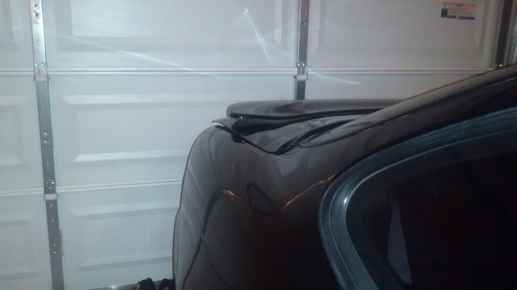

    Here's the only major problem with doing it myself.
    The trunk lid is pushed over the other panel so it can't open so I guess I need a way to put it back into place just to get it off
    And this is what it looks like farther back

    Maybe grab the raised part with some gloves and try yanking it over to help, seems the latch and hinges might be binding. Or carefully put a block of wood on that corner above the tailight and smack the trunk lid over with a hammer to shift it back into place.
    Yep. If you can get in the trunk from the back seat with a light you can probably get the trunk open with a scredriver or prybar. Just try not to damage the latch. Is the drivers side rear quarterpanel damaged at all? If not, that looks like an easy fix. I would certainly look for a lid elsewhere. If people really pay those prices, I am in the wrong business.

    have to ask...you try the key? looks to be pressure on the lock where the power lock might not have the power to open the latch.
    if it comes to it, take the back seat out, grab a flash light and a 10 mm on a extension and take the lock off.

    Can't say I have but I think it's the fact that the trunk lid is pushed over on top of the quarter panel on the passengers side. It might be kind of hard to tell in that picture. I'll try to get a better pic

    I do not suggest swapping hinges yet. You'll crack the seam sealer and have a trunk leak. If the front corner sticks up too high, gently overextend that side's hinge (open lid too far) a little to bring the front corner down. If the striker holds the lid to one side, whack it with a 2x4 to bump it back.
