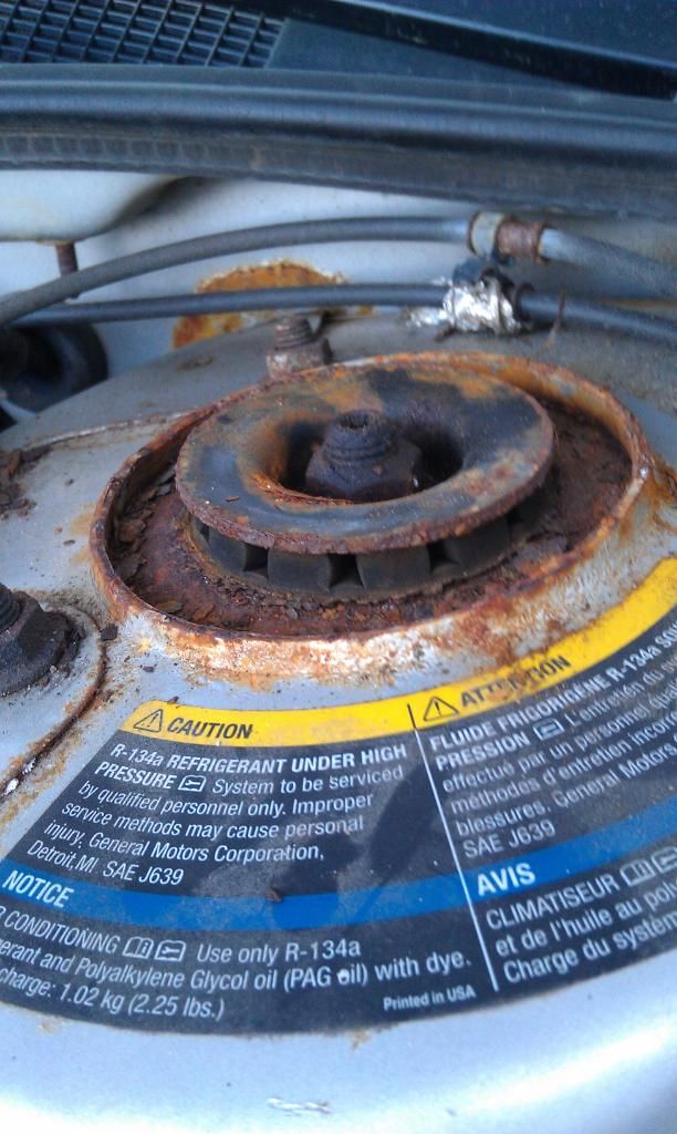

    what about just using KYB struts and stock springs,? what kinda ride ya think Adrian?
  2. #2 Re: what is this, why is it like this, and what should I do?? [pic]
    London Ont, Canada
    10,703
    i really wanna get rid of the clunk.. id love to do Kyb's and SSC's all way around.. but dollars.
  3. #3 Re: what is this, why is it like this, and what should I do?? [pic]
    Donating User Odi's Avatar
    Chicago South Suburbs
    5,928
    wont be that much more than getting quickstruts honestly.
  4. #4 Re: what is this, why is it like this, and what should I do?? [pic]
    while your mount looked a bit rusty, it kinda looks ok. if they dont move leave em. and then check your lca's, they were the source of a lot of my front end noise. after new lca's i no longer hear thumps or bumps when i hit bumps and pot holes, still avoid them but when you have no choice it rides better over them now.
    and for all you front end clunker guys check the lca"s, they cost 100 shipped to your door on line.
    or theirs a guy selling a pair and a solid sway for 100 all new. on this site.
    i really cant believe hes still trying to sell them, i thought they'd last a day or 2 but still there. its a killer deal if you ask me.

    ^^ check your rear struts. especially the spot where they mount as it tends to rust. if your fronts look like that im sure you need the rears too.

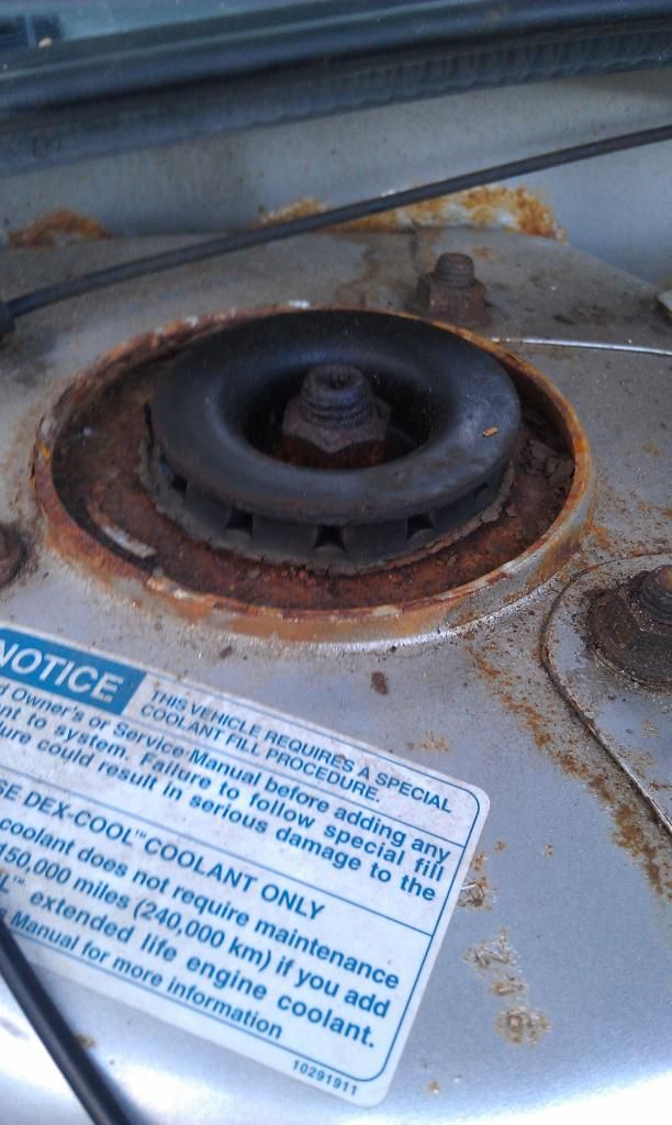

    1,504
    so considering that a few other's posted pics of their mounts.... I may as well do the same (Pretty shot will be ordering new ones)
