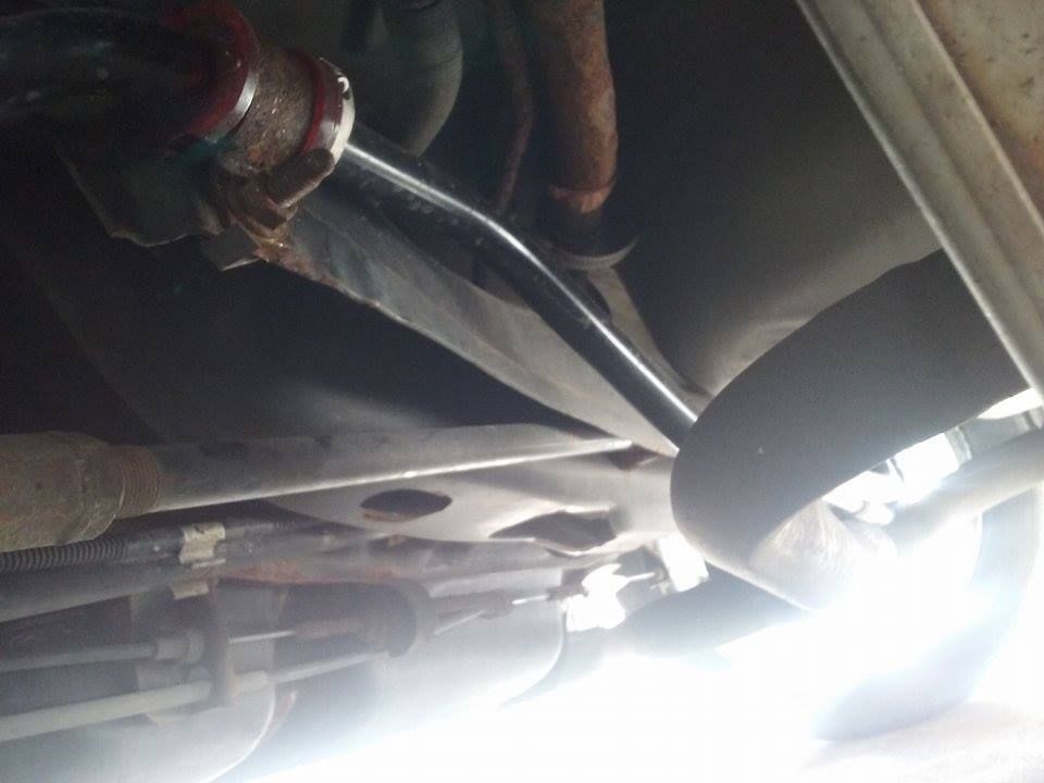

    Okay guys so I redid a good amount of my suspension... and I apologize for not taking pictures beforehand but I was so obsessed with getting this stuff on I forgot to take pics... A good friend helped me out and we did this stuff in about a weekend's worth of work
    Here's what's new:
    -Delco replacement control arms w/ Moog's problem solver bushings
    -OEM junkyard front sway bar (28 mm) w/ energy suspension bushings and new links
    -Rear ADDCO 22 mm solid bar w/ urethane bushings that came with it + Duralast links
    -KYB GR2 struts all the way around
    -Vogtland FRONT lowering springs 200# as stated in the forum (been almost 2 weeks, settled maybe a quarter to a half inch)
    -WBS REAR HEIGHTENING springs 350# as stated by WBS (settled a little, about a little higher than stock, maybe an inch, probably less)
    -ZZP shortened dogbones w/ poly motor mounts - Not yet put on
    -245/45/17 Kumho Ecsta 4X II
    Vogtland front springs
    Rear ADDCO bar
    Rear WBS springs
    Front sway bar w/ new links/bushings

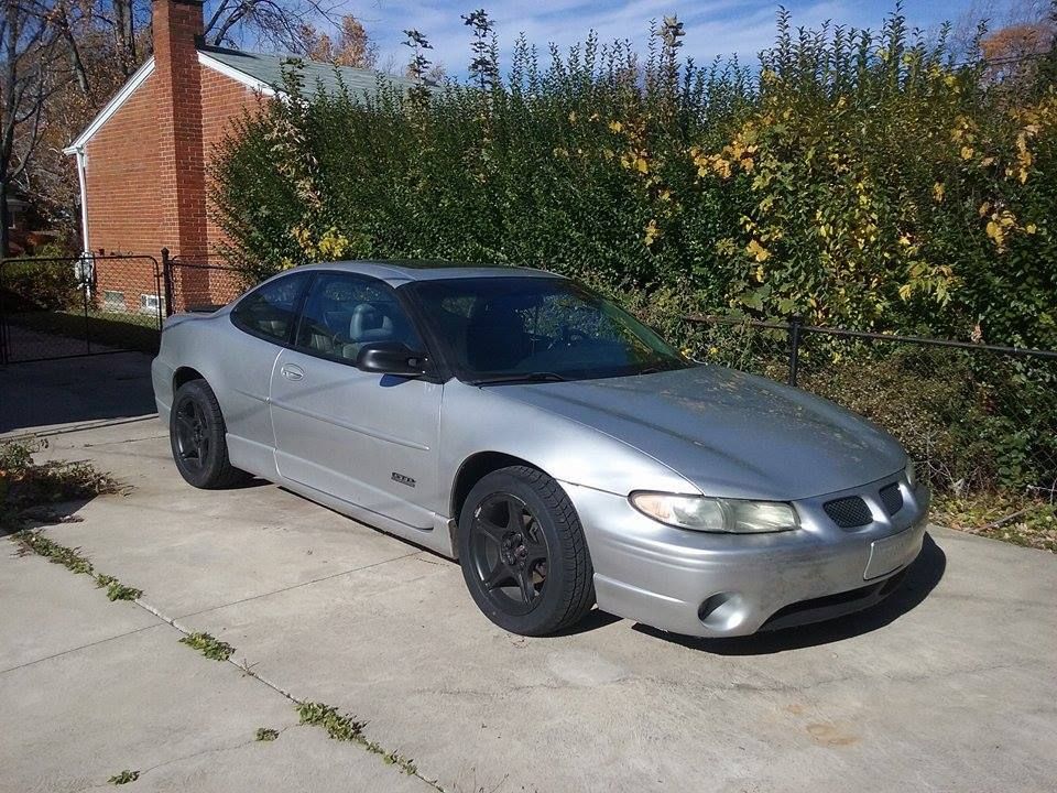

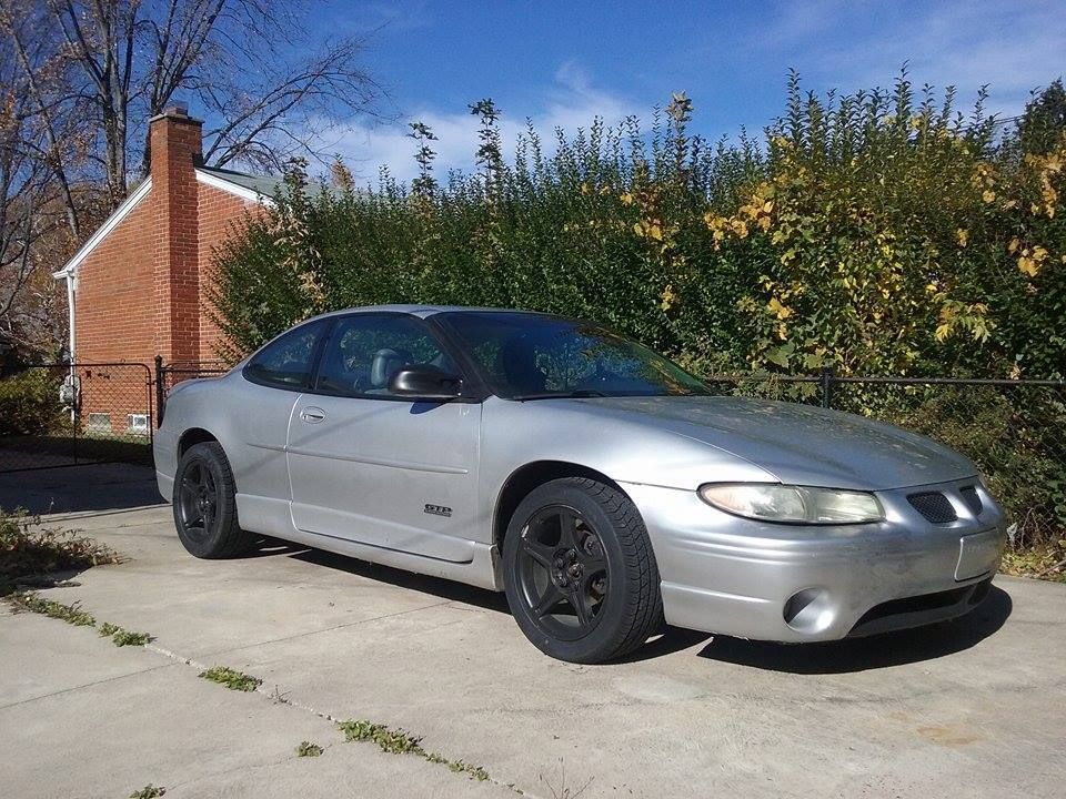

    How the car sits as of now
    Again, sorry for the bad images, like I said I was so obsessed with getting these parts on I didn't bother taking pictures, I had to go to a shop to get the new LCA bushings pressed in but other than that rust was a MAJOR issue, almost made me want to quit at many points
